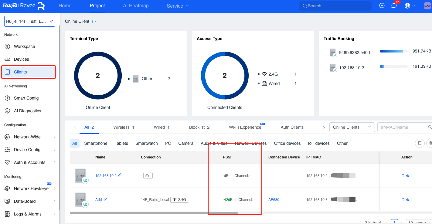

If your device is on the Ruijie Cloud, you may check the client status on the client list, make sure the RSSI of your device is green.

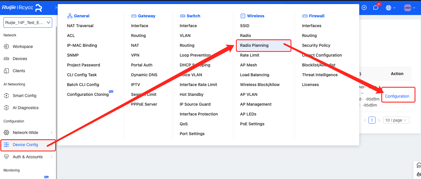

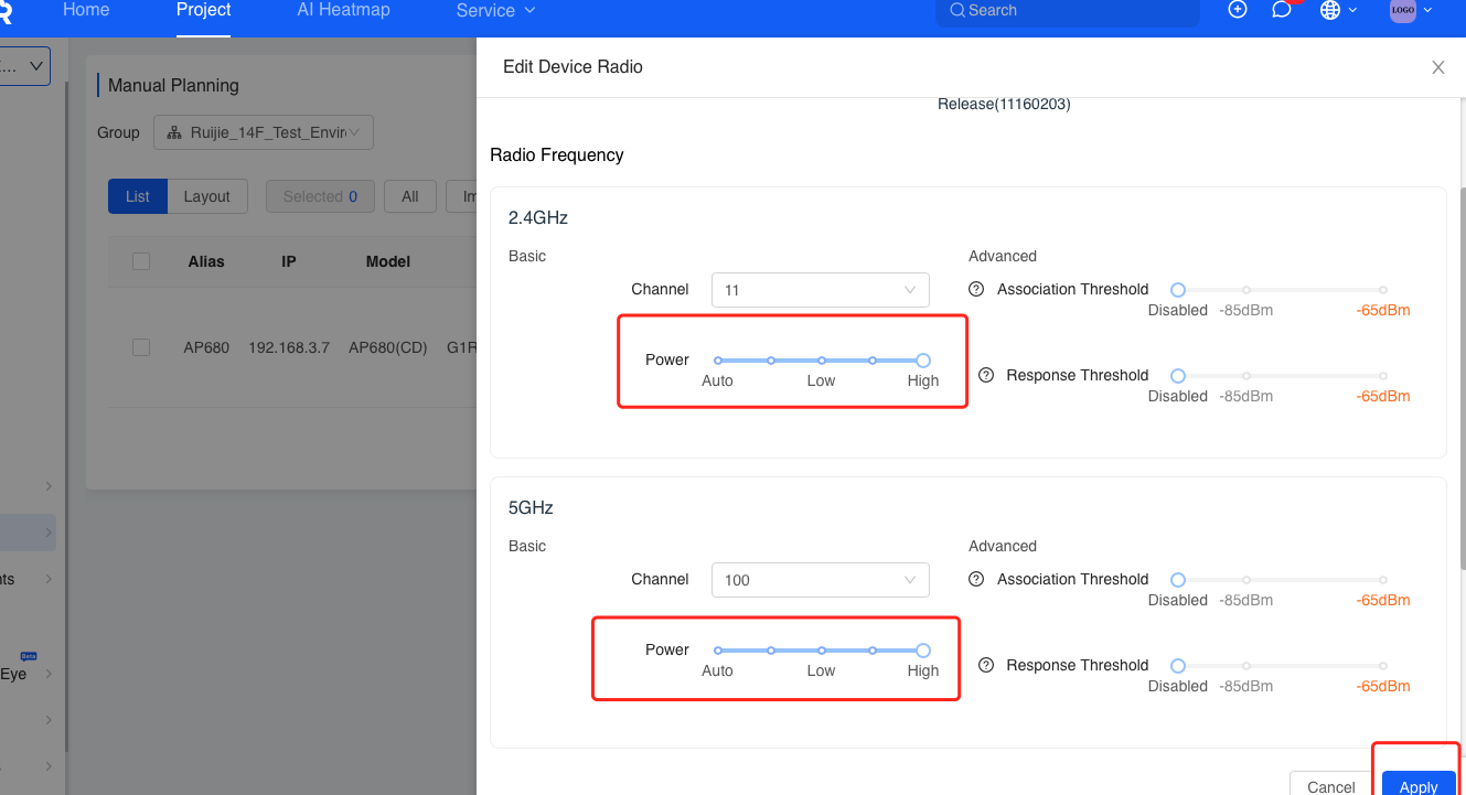

And make sure the radio power is high, and lower the roaming sensitivity of the radio.
After this you may try test it.
