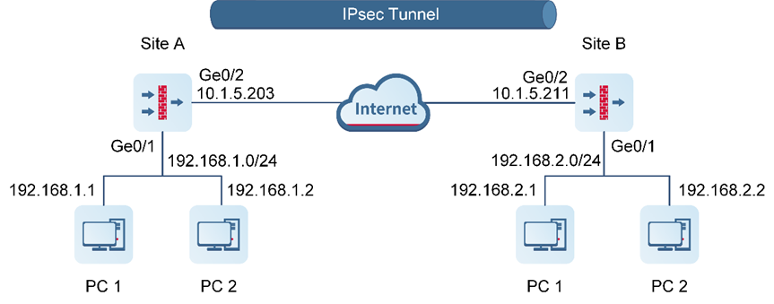

As shown in Figure, Site A and Site B at both ends have fixed public IP addresses. A point-to-point IPsec VPN tunnel needs to be established between the LANs of the two sites to achieve secure mutual access.
The authentication mode should be pre-shared key, and the encapsulation mode should be the tunnel mode. In this way, both ends can initiate connections.

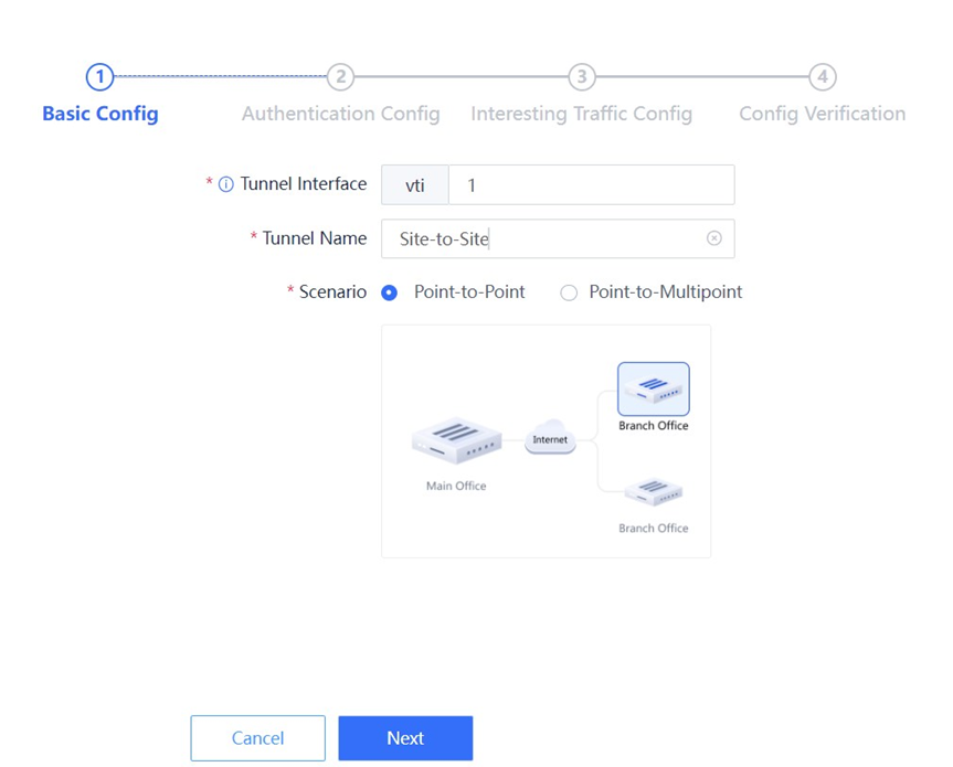

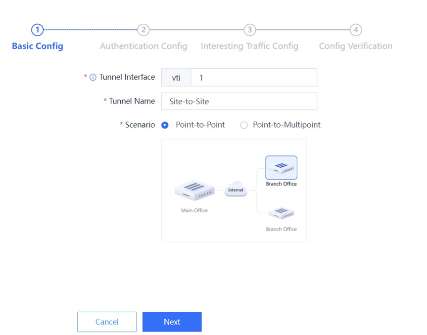

(1) Perform basic configuration.
(a) Choose Network> IPsec VPN > Config Wizard. The basic configuration page of the configuration wizard is displayed.
(b) Set Scenario to Point-to-Point, and set the other parameters according to the following figure.
(c) After completiong the configuration, click Next.

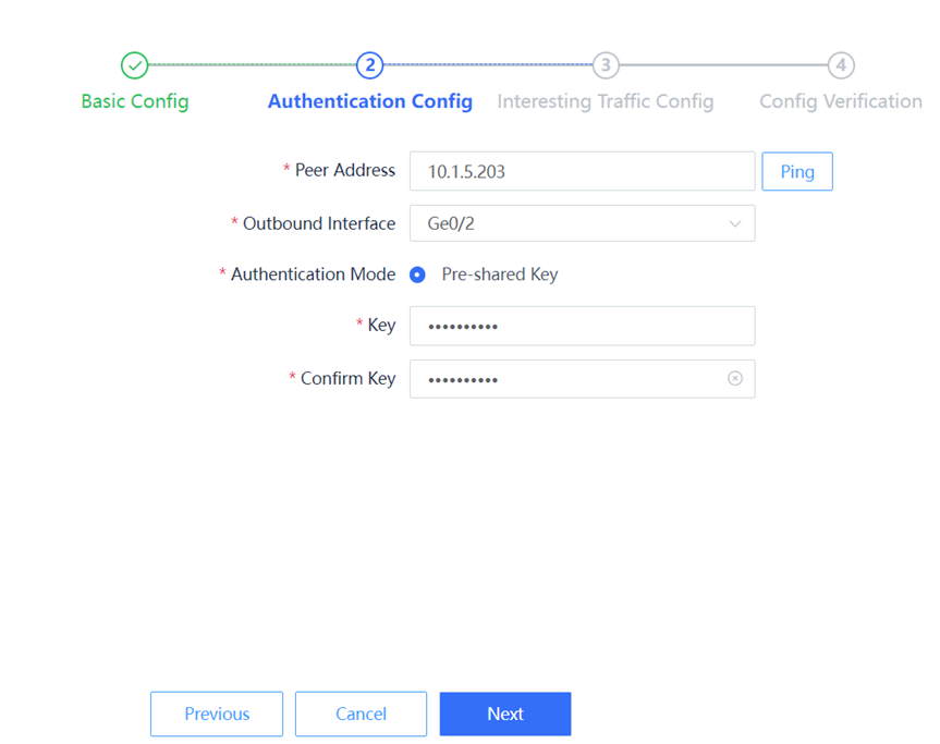

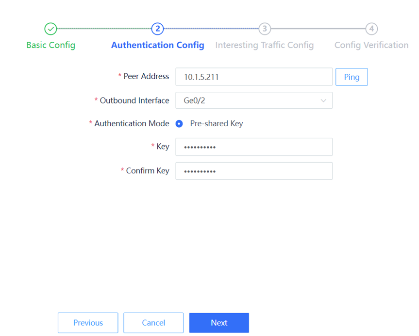

(2) Configure authentication.
(a) Configure parameters according to the following figure.
(b) After completing the configuration, click Next.

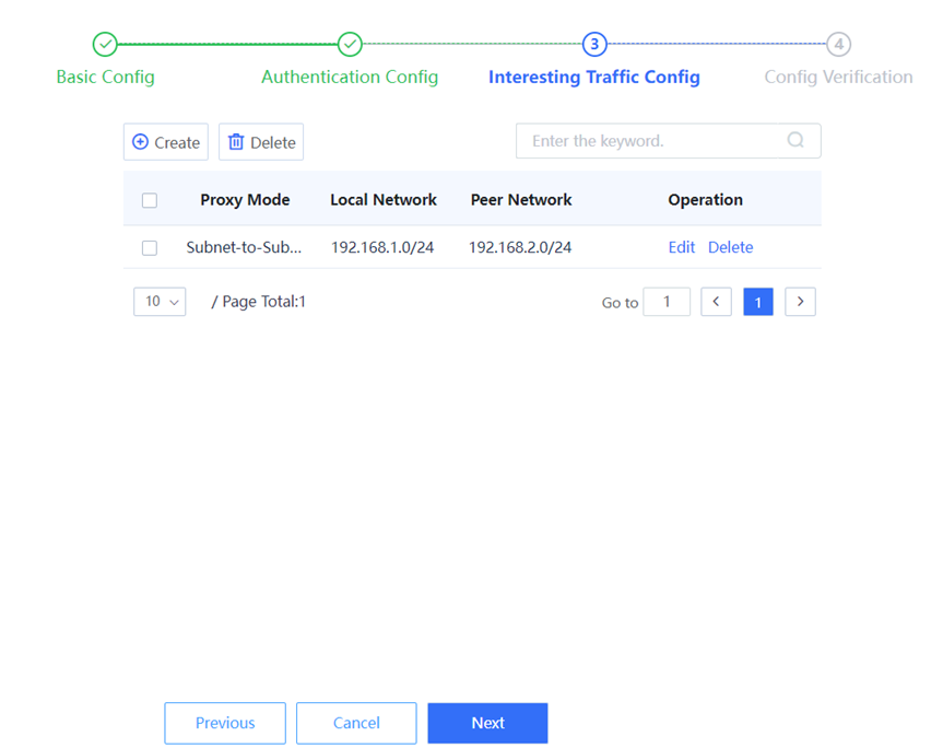

(3) Configure interesting traffic.
(a) Click Create. Configure parameters for interesting traffic according to the following figure.

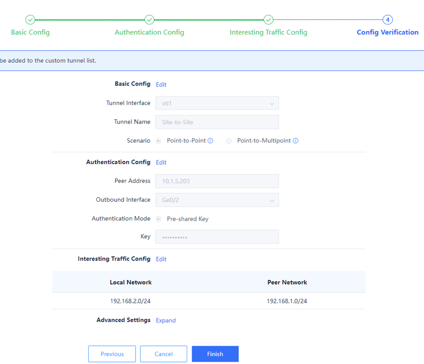

(4) Verify configuration.
(a) After verifying the configuration, click Finish.
(c) After completing the configuration, click Next.

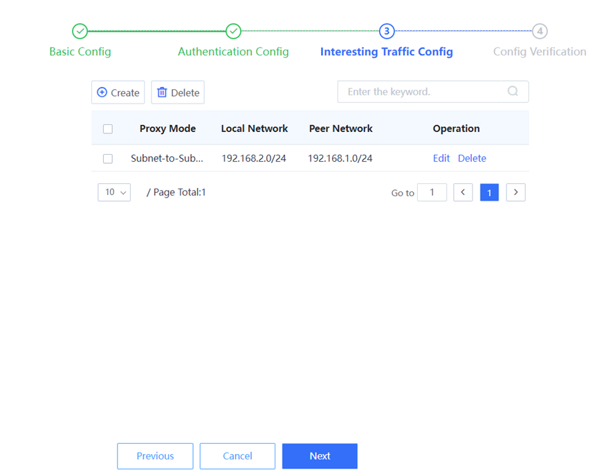

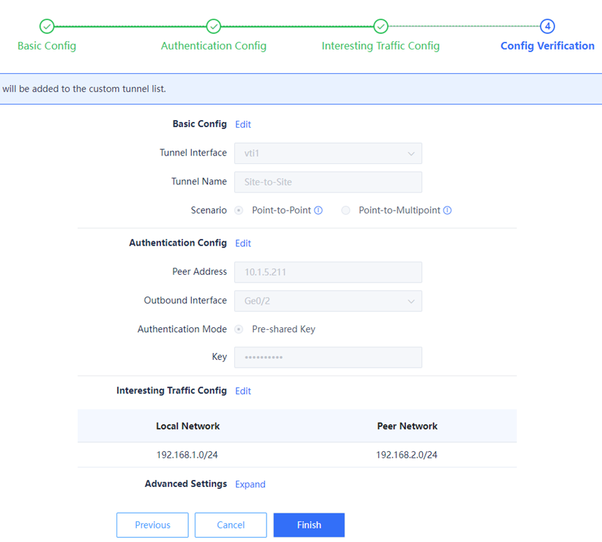

(a) Click Create. Configure parameters forinteresting traffic according to the following figure.
