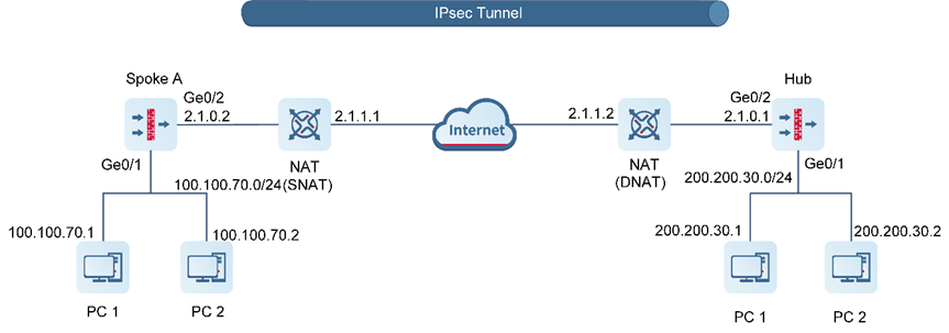

In a scenario of IPsec VPN with NAT traversal, static NAT (SNAT) needs to be deployed for Spoke A to initiate a connection with the hub site, and dynamic NAT (DNAT) needs to be deployed for the hub site. Figure shows the typical networking diagram.

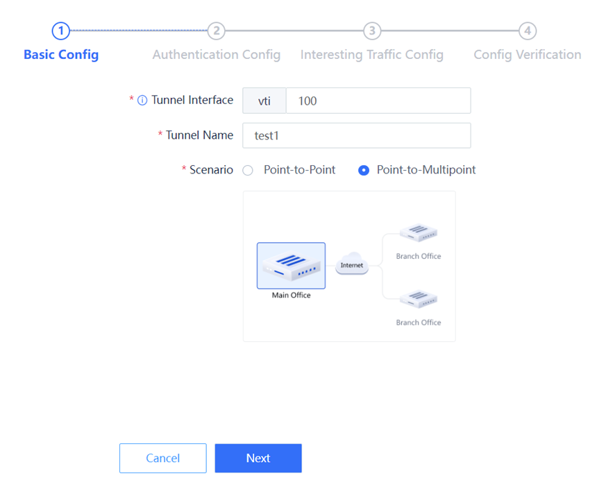

  • Configuring the Hub Site
(1) Perform basic configuration.
(a) Choose Network> IPsec VPN > Config Wizard. The basic configuration page of the configuration wizard is displayed.
(b) Set Scenario to Point-to-Multipoint, and set the other parameters according to the following figure.
(c) After completing the configuration, click Next.

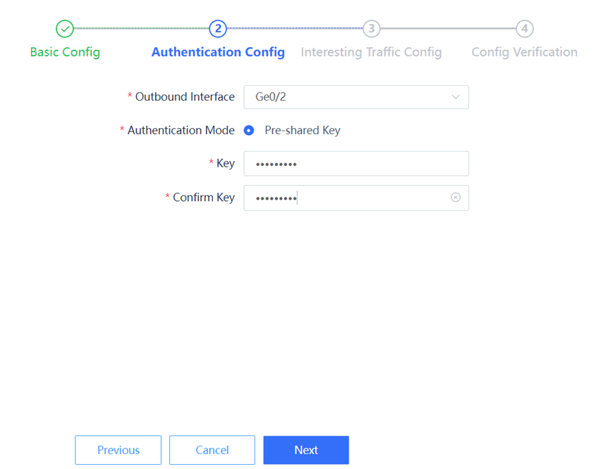

(2) Configure authentication.
(a) Configure parameters according to the following figure.
(b) After completing the configuration, click Next.

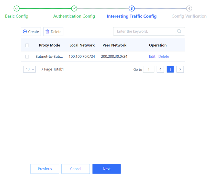

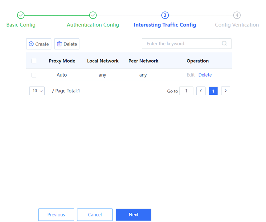

(3) Configure interesting traffic.
(a) Click Create. Configure parameters for interesting traffic according to the following figure.

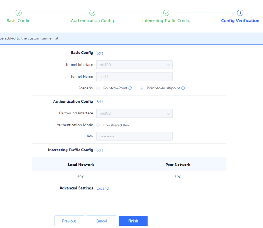

(4) Verify Configuration.
(a) After verifying the configuration, click Finish.

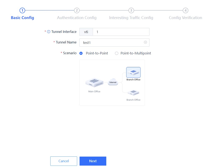

Configuring Spoke A
(b) Set Scenario to Point-to-Point, and set the other parameters according to the following figure.

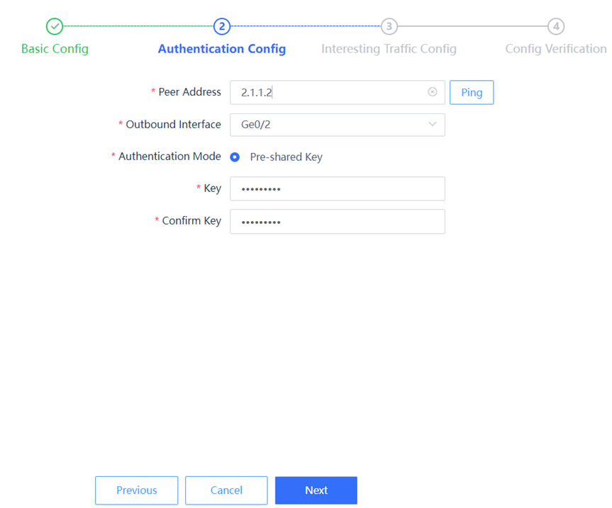

(4) Verify configuration.
