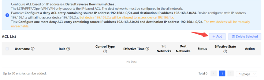

You can configure the Access control on EG
The guide is as follows
Choose One-Device > Gateway > Config >Behavior > Access Control.
The access control rule list displays the created access control rules. Click Add to add an access control rule.
Tips: If you want to isolate two subnets from both sides, you need to configure bi-directional acl.

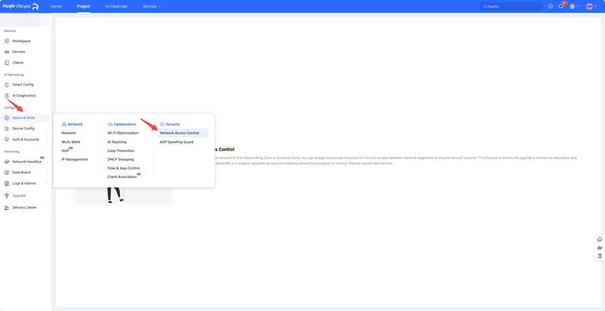

Click Network-Wide> Network Access Control

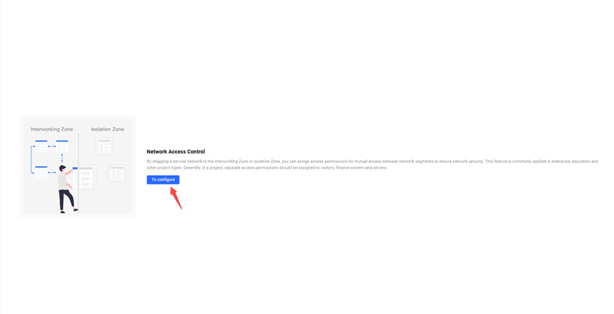

Click To configure

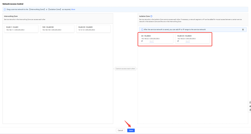

Drag and drop the two subnets you want to isolate into the isolation zone and click Save.
Click To configure
