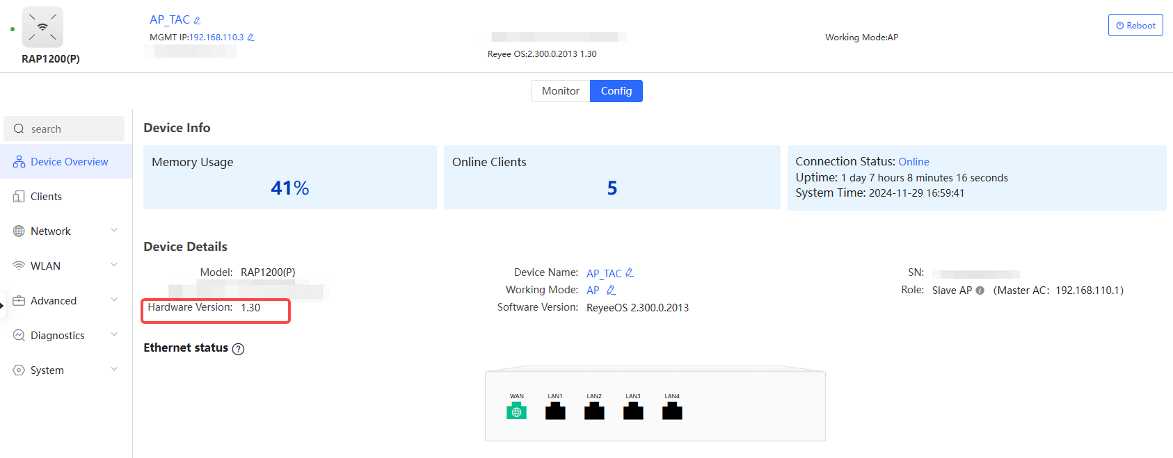

Please help us to see the hardware version of your AP as follows:

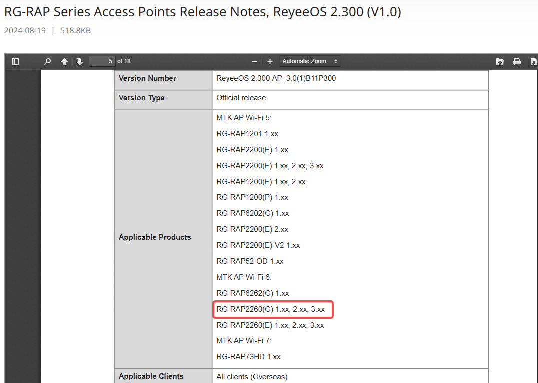

https://reyee.ruijie.com/en-global/resources/software/rg-rap2260g-firmware/2260g300/
Once you confirmed, you can try to install the latest version manually. The Reyee OS 2.300 is compatible with all RG-RAP2260(G) hardware versions as you can see in the next picture.
You can get the firmware from here

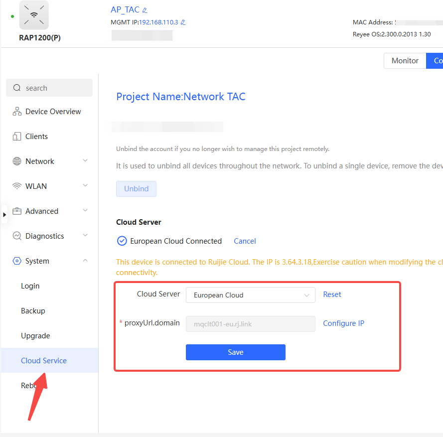

Please try to install it and after that check the cloud setting
Please let me know any update.
