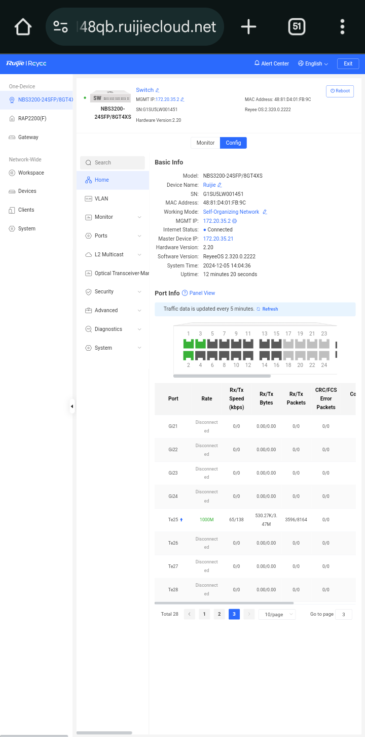

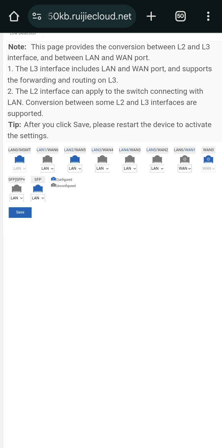

Have you checked the port mode you connected? Could you show me any pictures?
Lex
0 2024-12-5 14:09:18 View all replies
GTAC-Lex replied at 2024-12-4 18:59
Dear sir,
Good day.
RG-NBR6215-E PORT 8F connected to RG-NBS3200-24SFP/8GT4XS port 26F
