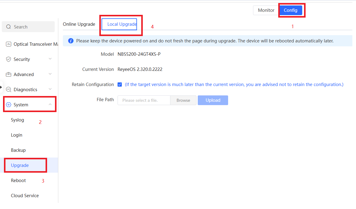

Dear User,
You can download the latest firmware for this model via the link below.
https://reyee.ruijie.com/en-global/resources/software/NBS3100-firmware/nbs3100-reyeeos280-firmware/
It is advised to upgrade your firmware locally in the web UI of the device to avoid the risk of damaging the firmware.

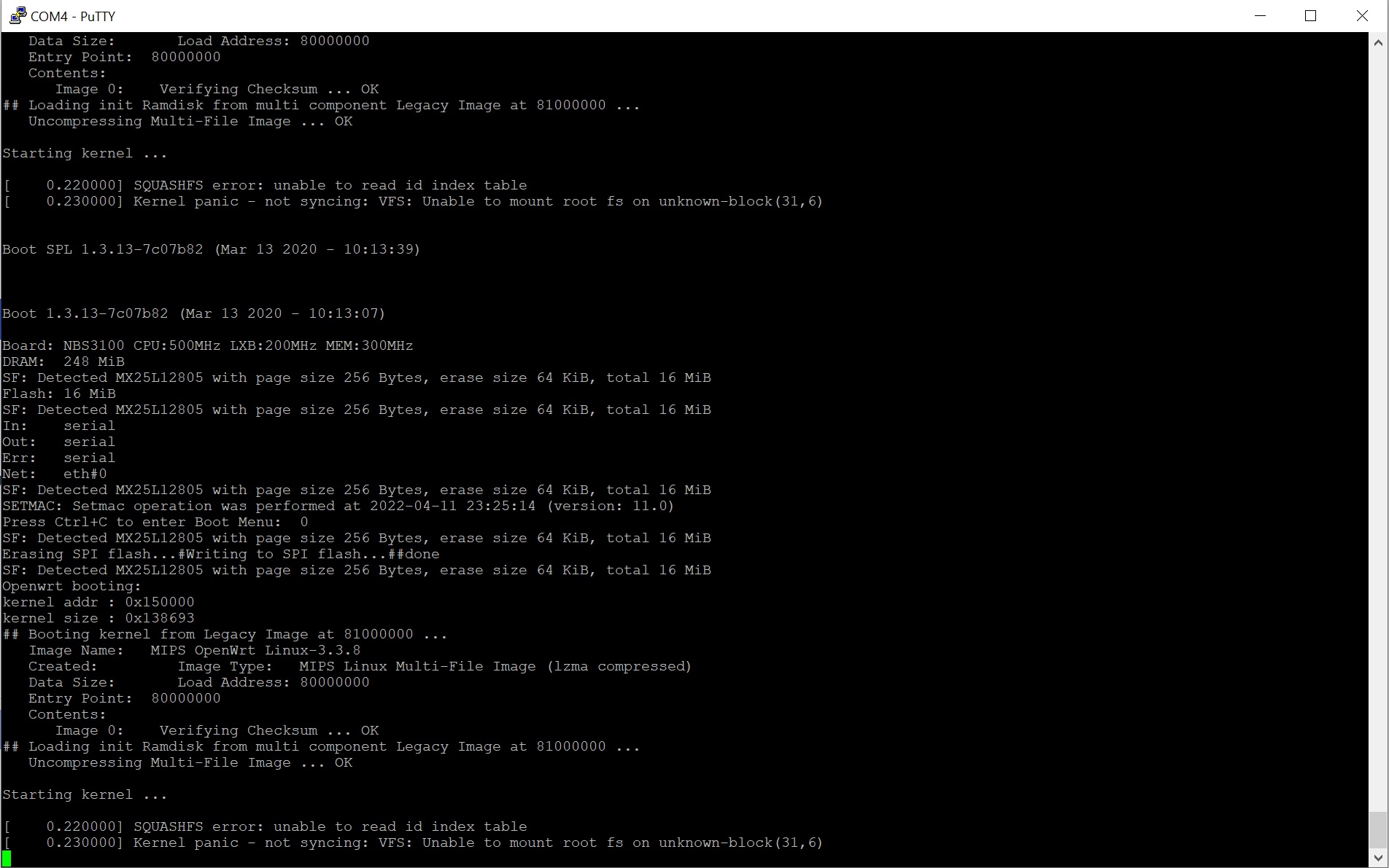

It does not start after the update, I connected to it via the com port.
The firmware that is on the site is not suitable.

Dear user,
The global version of NBS3100 does not have console port and can only be upgraded via the Web UI.
Please contact us on Rita(www.ruijienetworks.com/rita), our real-time support platform. Our dedicated engineers will help you check the SN of your device and see if it needs a China Mainland firmware version.
