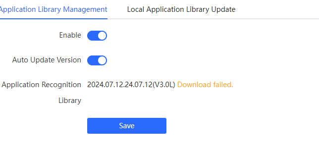

Morning Reyee Team,
Can i get the newest Libary Application file as mine files to auto upgrade even after a reboot: see below:
There should be a much newer version as its detected at random times.
This can be emailed to xzainelourensx@gmail.com for local upgrade
Thanks!

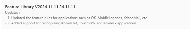

Hi!
Dear Sir 2024.07.12.24.07.12(V3.0L) is your current version,I will help you check if this is the latest one.

Correct but there is an upgrade had it display before but does not always do it.See below

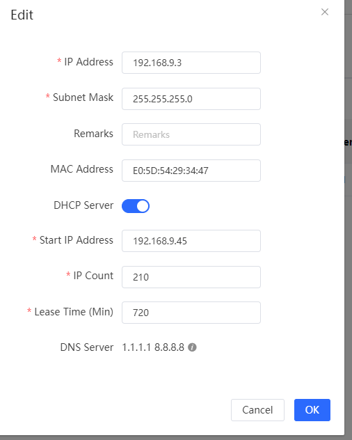

Hi sir,
May I know did you configure your device's DNS as 8.8.8.8?
If so, may you tell me your email address, then I will send you the latest Libary Application file.

Hi Steve,
This would be great, email: xzainelourensx@gmail.com
and to answer your question DHCP Lease + Proxy had to set it a few places on the EG for it to work correctly but seems to be avoiding ISP Provided DNS via PPPoE now and using Google + Cloudflare
