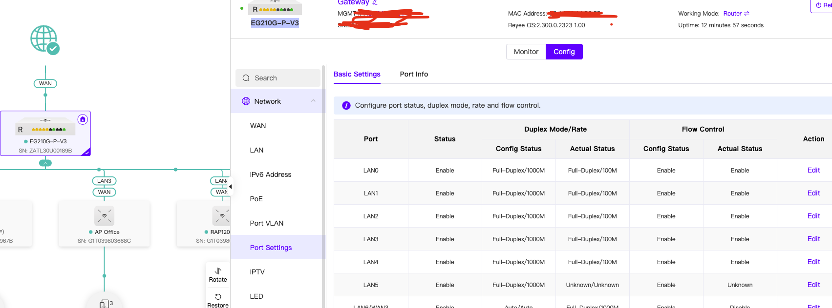

Hello, on my network I have a speed at around 300Mbps. When I connect a device directly on the router I have the same speed. But with the AP RG-RAP1200(F) it's limitated to 100Mbps. You can see on my config that I put Full Duplex/1000m but the actual status is still 100M.
I tried to reboot but I don't know what I have to do to remove that limitation. My house has ethernet cables of category 6.
If someone can help me to understand please. Thanks

Hi,
correct, is limitated to 100Mbit as the AP has only Fastethernet ports connecting to the router so more than that speed you cannot obtain.
Regards
Marco

Dear sir,
Checked from the datasheet of RAP1200(F), it only have Fastethernet ports.
Lex

Mturco84 replied at 2024-12-10 21:17
@Fabrice Trey you can take RG-RAP1201
that has Gigabit ports for example.
Regards
Thanks Marco
