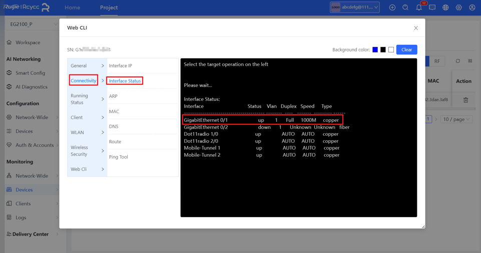

2. The upstream wired port bandwidth of the AP is insufficient.
View the negotiated rate of AP's upstream wired port
If the port of the AP supports negotiation for 1000M, but the current speed is not 1000M, then:
Check if the network cable supports 1000M.
Check if the port connecting the upstream device and the AP supports 1000M.
Replace the network cable for testing;

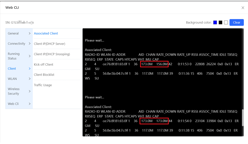

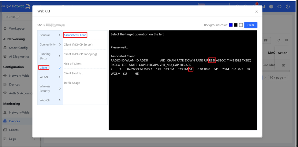

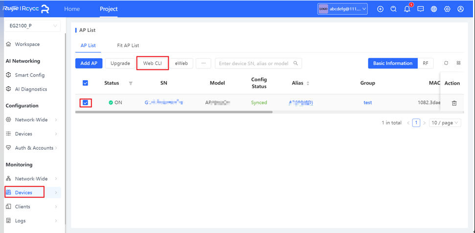

Viewing the RSSI value of wireless users on the AP: Monitoring > Devices > AP > Tick AP, click Web CLI
<Client > Associated Client:
Note:
The RSSI value displayed here by clicking the button (corresponding to the command: show dot11 associations all-client) in Ruijie AP indicates the received signal strength, ranging from 0 to 100 (the corresponding wireless user signal strength is -95 on this basis, for example, RSSI 51 in the figure above, corresponding wireless user signal strength is 51-95 = -44dBm).
If the RSSI value is low (below -60), it is recommended to close the terminal to the AP or increase the power of the AP appropriately, so that the terminal user can obtain a higher RSSI value.

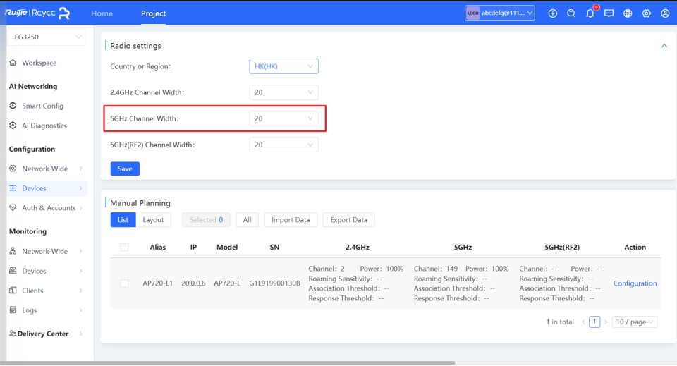

The negotiated rate is related to the RF Channel Width. When configured with a higher Channel Width, both wireless users and AP will have a higher negotiated rate. At the same time, a higher Channel Width will also bring more wireless interference compared to a lower Channel Width.
As shown in the figure above, the user is currently connected to the 5G SSID with a negotiated rate of RATE_DOWN 173.0M and RATE_UP 173.0M.

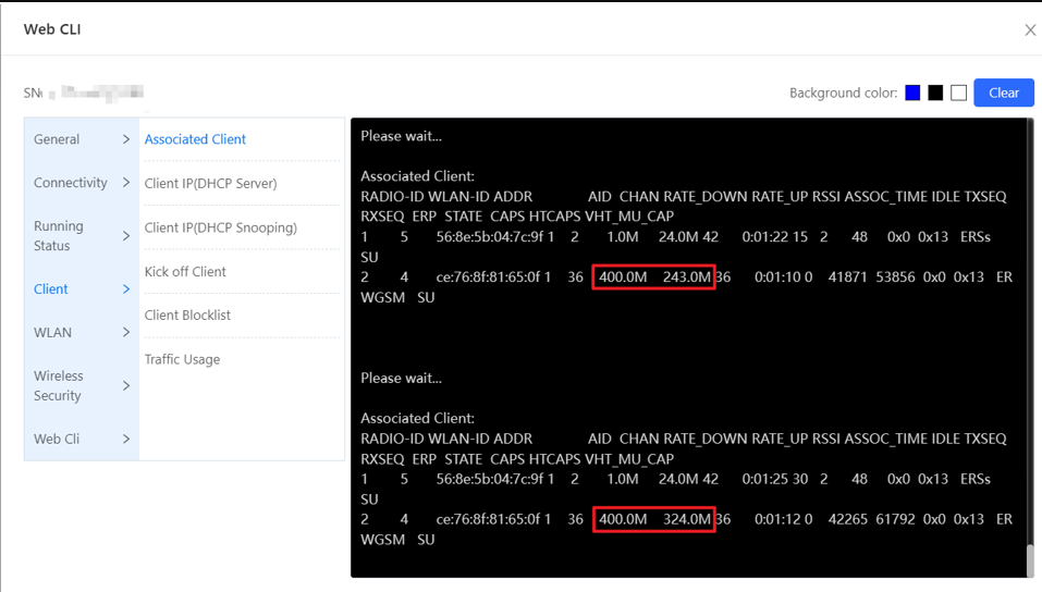

After adjusting the 5GHz Channel Width to 40, perform another speed test and check the negotiated rate.
You can see that the negotiated rate is higher when the 5GHz Channel Width is set to 20M.

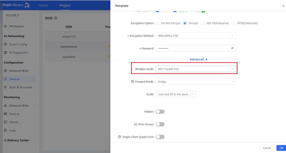

If the AP supports Wi-Fi 6, you can enable Wi-Fi for testing.
After enabling Wi-Fi 6, perform a speed test again and check the negotiated rate.
If the negotiated rate is still low after changing to Wi-Fi 6, please try the following steps:

Note: If users can obtain sufficient negotiated rate with a lower Channel Width, it is not recommended to increase the Channel Width to avoid causing greater wireless interference.

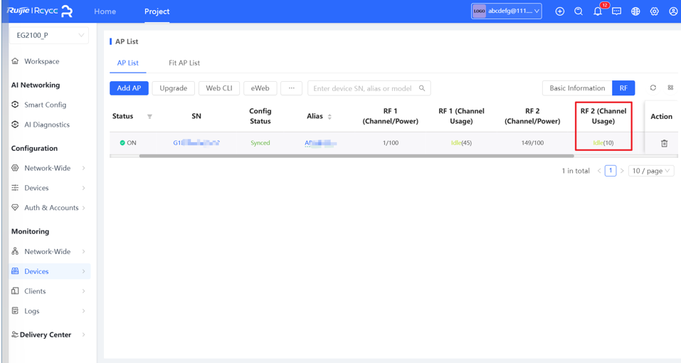

5. Congested channel

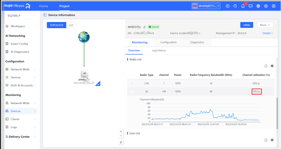

View the channel utilization of the current AP. There are three statuses of Channel:
Idle: 0%-59%
Busy: 60%-79%
Overload: 80%-100%
When the channel utilization status is Idle, it indicates that the current channel used by the AP is relatively free and there is less wireless interference. When the channel utilization status is Busy or Overload, it indicates that the current channel used by the AP is crowded and there is more wireless interference. It is recommended to change the channel used by the AP.
Click on SN to enter the AP details page and you can also view the historical channel utilization.
If the channel utilization rate is high, you can try changing the channel and testing again.

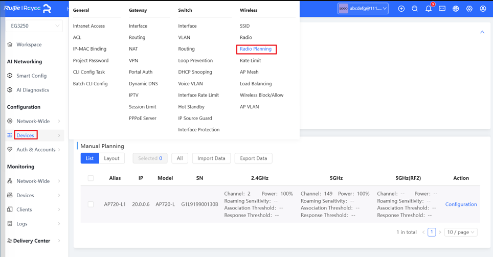

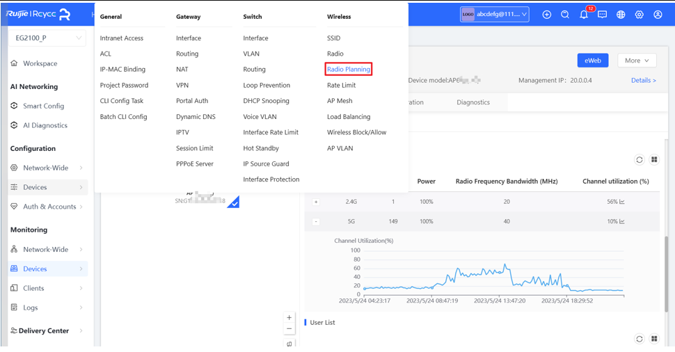

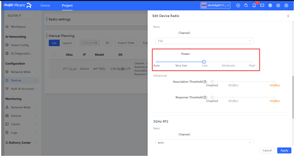

6. The power configuration of the AP is not suitable for the current environment.
When APs are deployed close to each other or when the channel utilization of an AP is high, you can try reducing the power of the AP to reduce wireless interference.
When the terminal is far away from the AP, you can try increasing the power of the AP.
