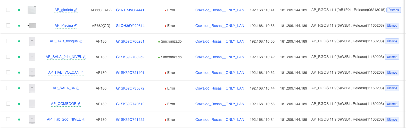

I have the problem that several devices (AP's) are reporting the error "Country Code and Bandwidth".
How do I solve the problem?
RG-AP820-I

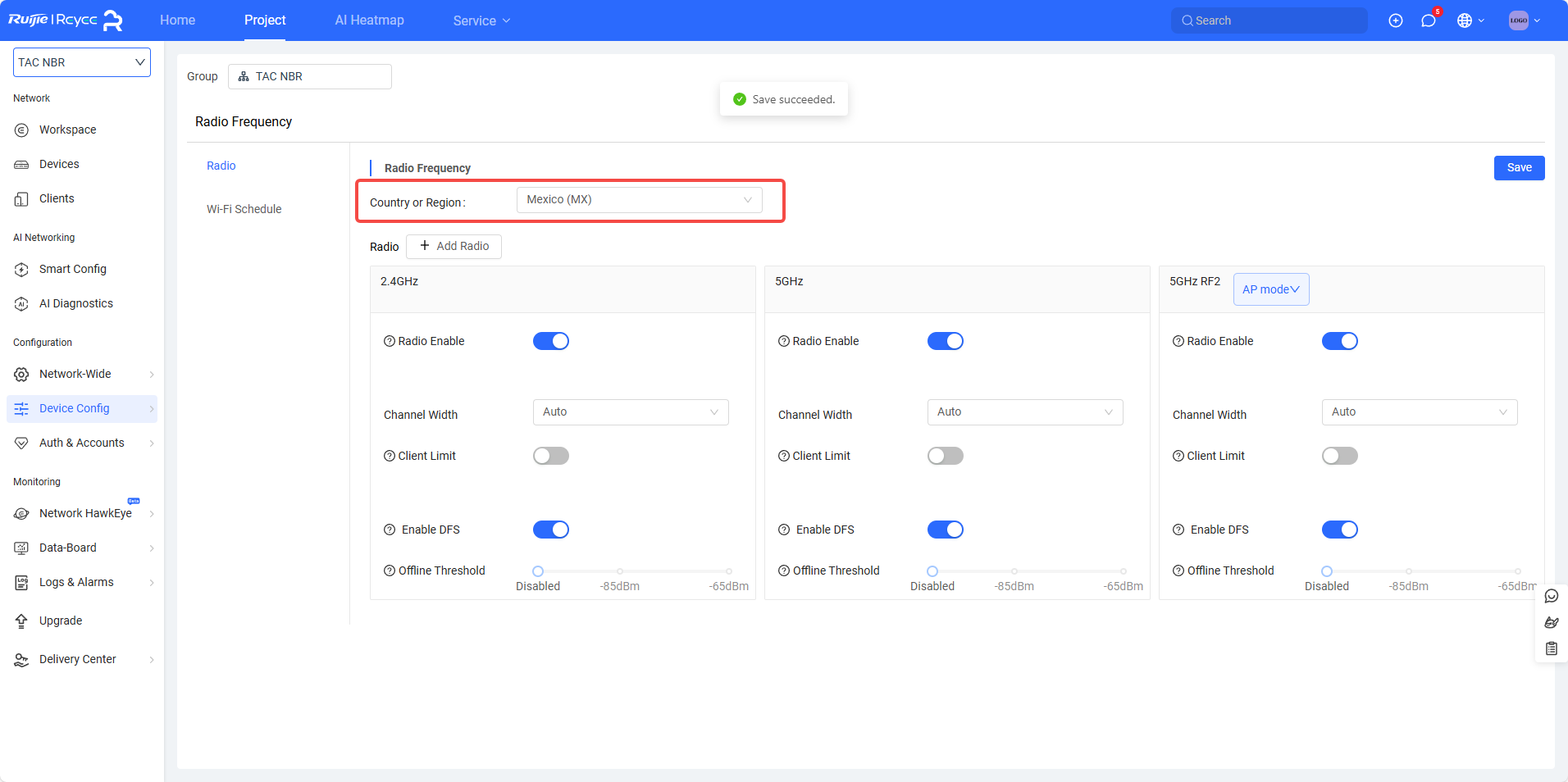

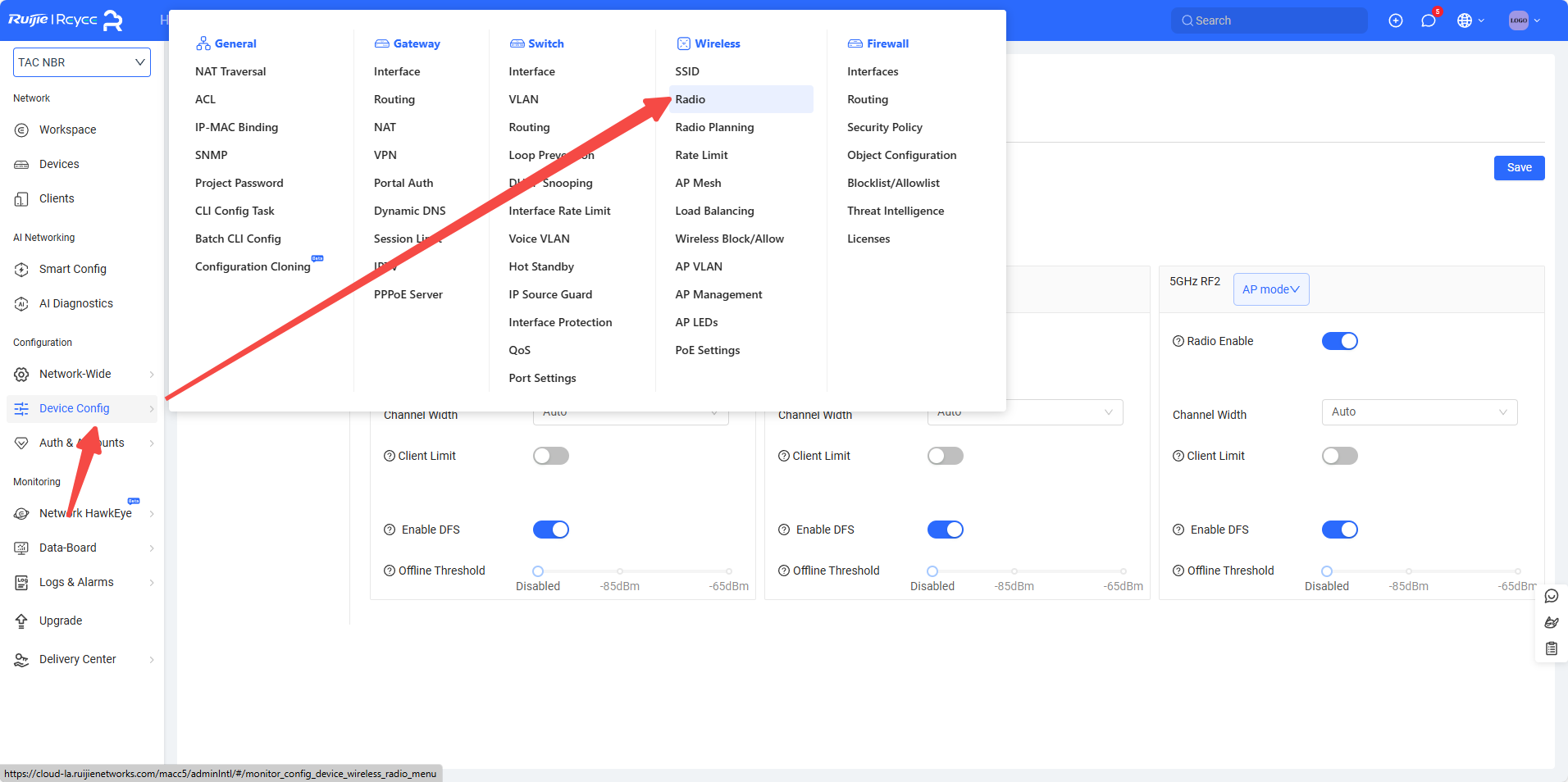

Hola Rodolfo, you canc heck the country code from cloud in the radio option as follows
on that way you must be able to sync the devices with the correct country code.
Regards!

In theory we are fine in that configuration... we have it as our country... (Guatemala)

I have several computers, in some we don't have that problem, and in others we do... and we have the same configuration

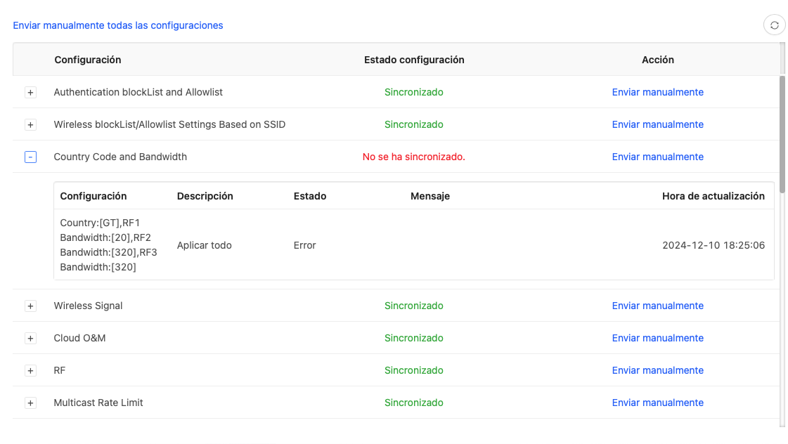

Rodolfo you can join us in Rita live chat to see a detail your issue and share the network with us, if the country code is correcty setted ad you mention on the cloud need to check devices on detail.
Reagrds!
