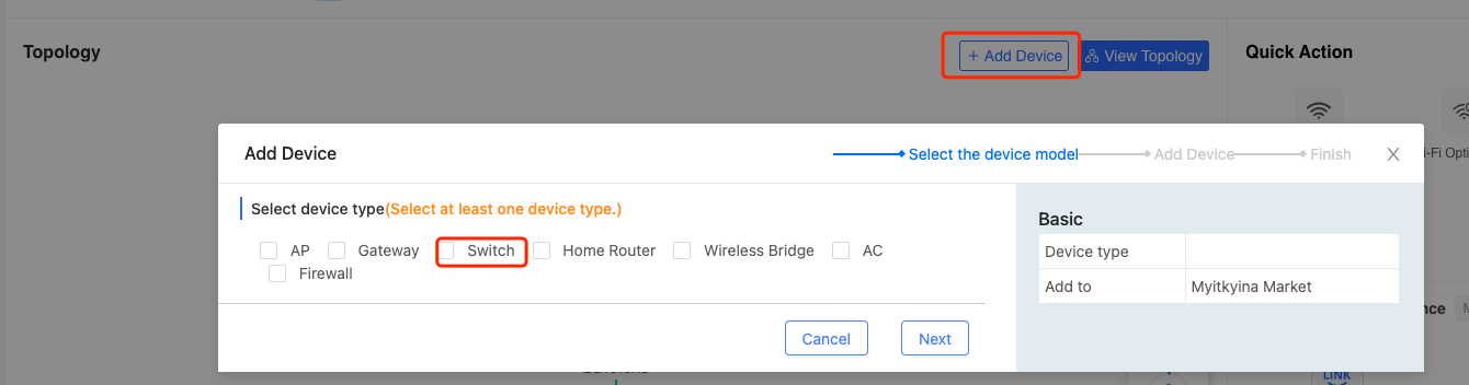

Dear sir,
Have you tired add the S5760 to the cloud by SN?
If this is not working you can also configure S5760 as viurtual device to skip the limitation.
Besr Regards,
Lex

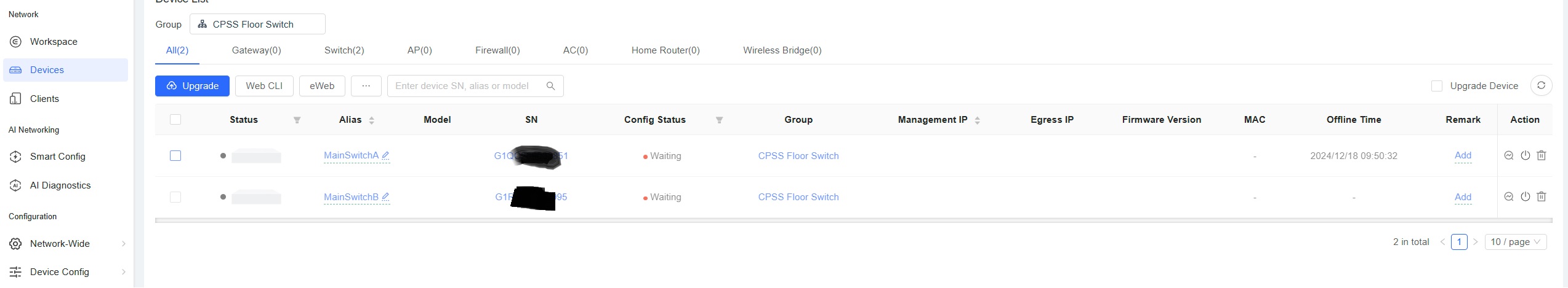

yes i tried before, but it keeps show offline, the cloud not found the switch.
the switch is keep using as stacking mode
