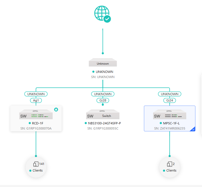

I already configure my switch to be access switch and the uplink already done. The uplink works and I can ping to this switch from other switch but the other port on this switch don't have any internet access and does not receive ip from my dhcp server. Please can help me solve this matter?

This is my device model NBS3100-24GT4SFP-P-V2. The RDC-1F is the master. The device connected to switch but don't received internet. Or you can do remote session for this?

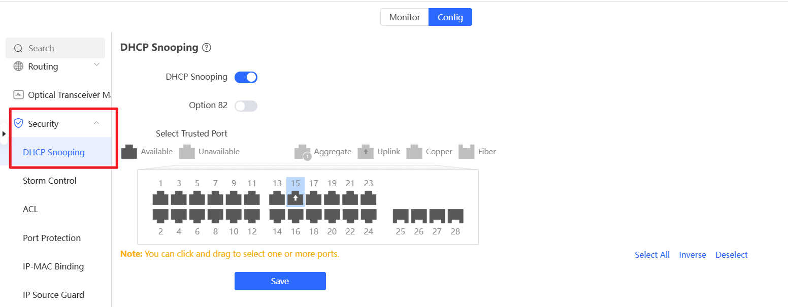

b. Check the DHCP configuration of the gateway

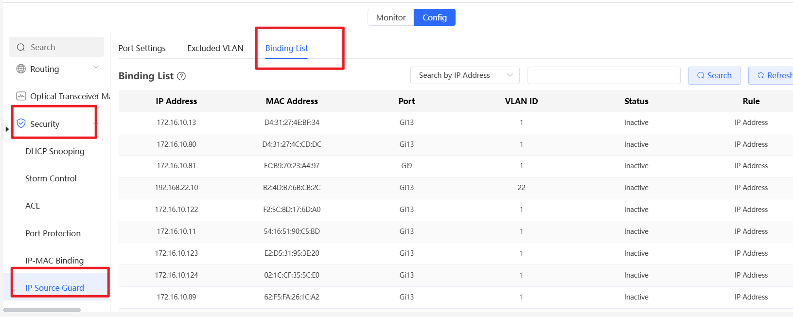

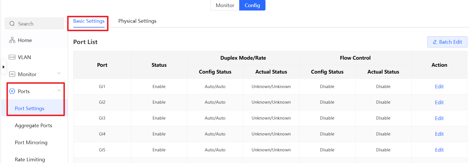

c. Please check vlan and port configurations and other settings of the NBS switch. The paths are as follows
If the issue still exists, please help to collect the test result and share your test screenshot with us. I would be glad to help you in Community.
