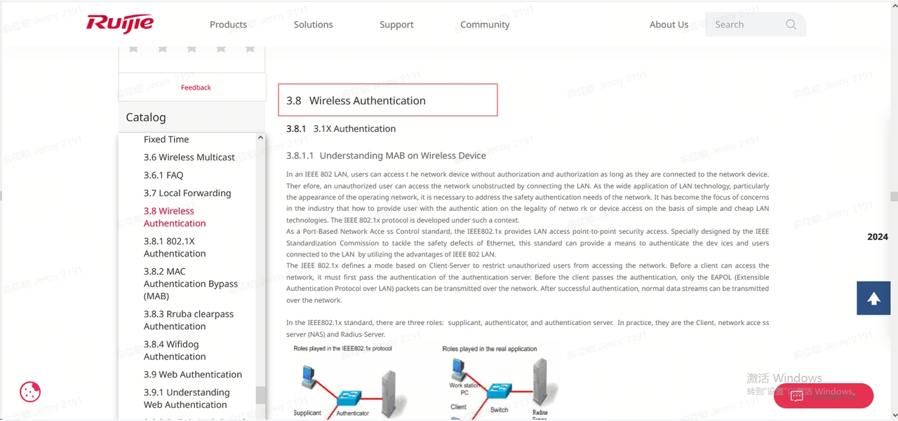

Hi,
Ruijie access controller can support 802.1x authentication, MAC authentication bypass authentication, wifidog authentication, web authentication including iportal, eportalv1 and eportalv2 authentication. You can refer to the following link about the wlan authentication configuration:
https://www.ruijienetworks.com/support/documents/slide_75752/#
