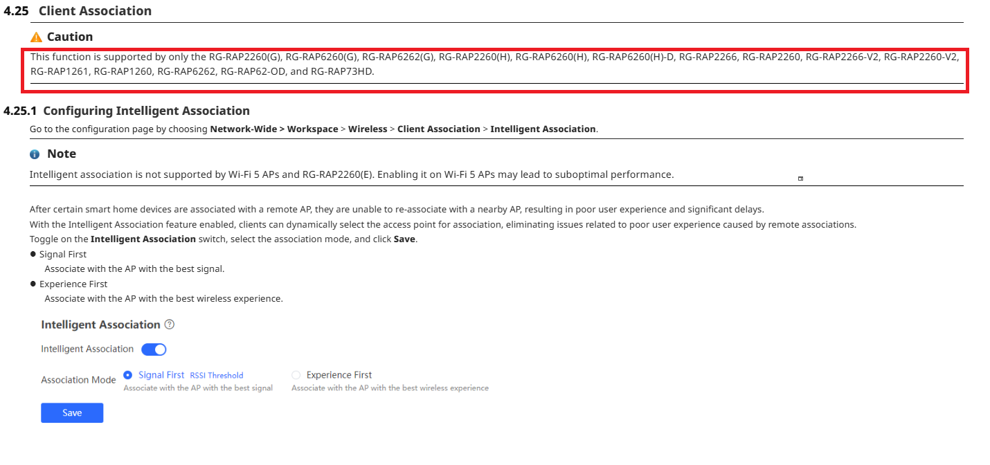

This feature is designed to address scenarios where client devices remain associated with a remote AP for a long time, resulting in poor user experience, such as when a home IoT device connects to a remote AP and fails to switch. You can use this feature to configure wireless clients to connect with the AP or the designated SSID under the AP, thus solving the problem of poor user experience.
I need this feature, but my project does not support Remote Associations. Cause: The master device firmware version is not supported. Upgrade the firmware version and try again. My devices are 3 RG-EW3000FX PRO units, on the 1st floor as master, 2nd and 3rd floor as mesh APs, what settings are wrong and what do I need to add?

Dear AgungFH,
The Intelligent Association in the SoN interface is not supported by the EW series. It is for WIFI 6 Reyee AP models.
https://reyee.ruijie.com/en-global/support/documents/slide_rg-rap-series-access-points-reyeeos-2-320-configuration-guide/
We encourage you to contact us on Rita(www.ruijienetworks.com/rita), our real-time support platform, so we can know more about the deployment of your RG-EW3000GX units. With these information, we can adjust the RF power and roaming sensitivity accordingly.
