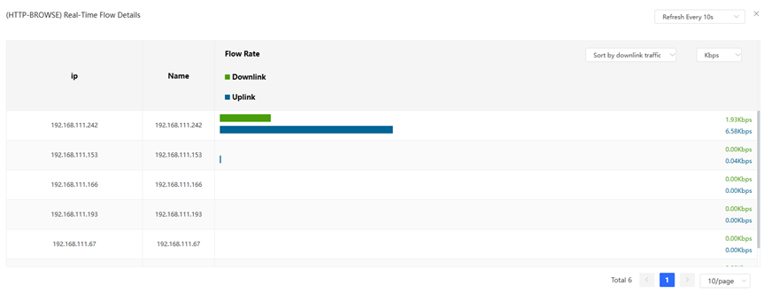

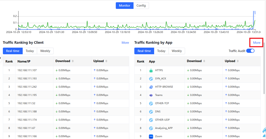

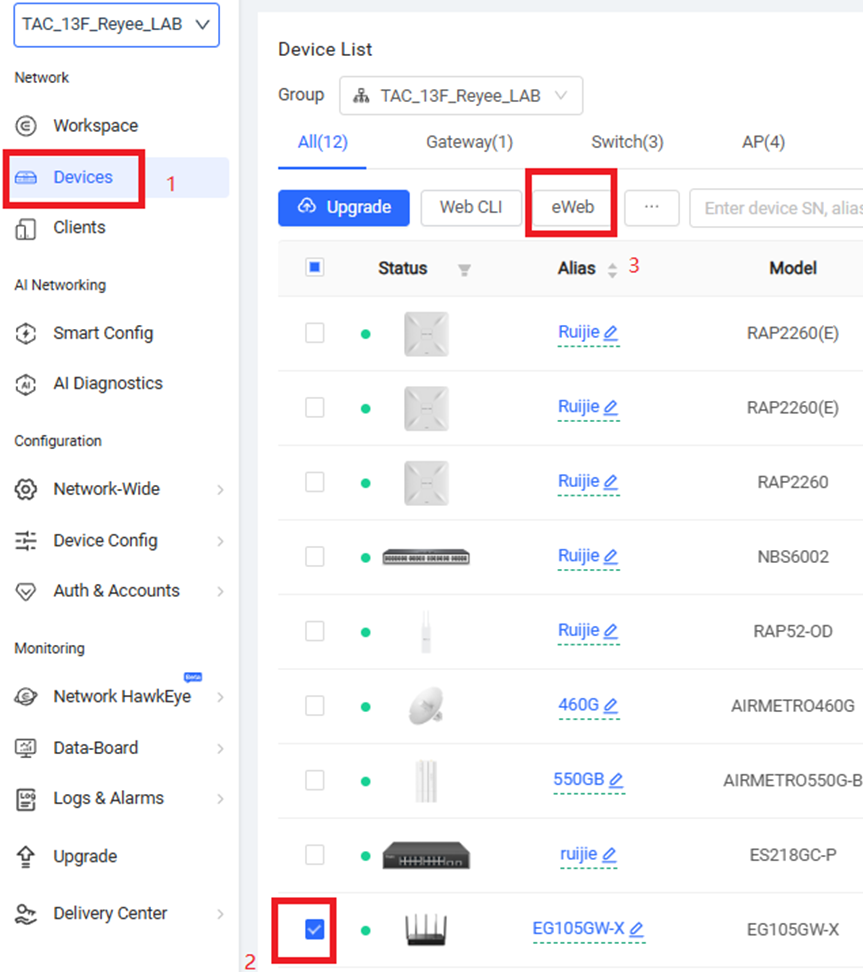

Go into the monitoring page in the eWEB of the EG, and click "more" in the "Traffic Ranking by App" table.

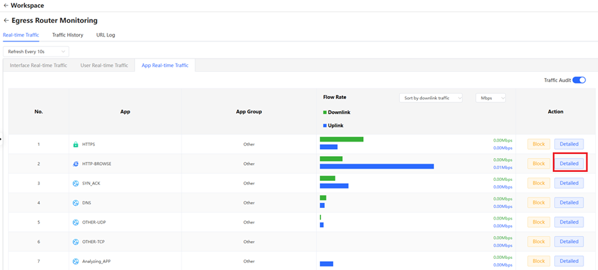

Click the "Detailed" button of an APP.
The IP of the devices that are using this APP will be displayed in the pop-up window.
