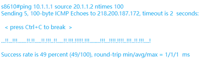

(4) Begin Ping Packet Testing
Next, ping 10.1.1.1 from the S86 with 100 packets.
Under normal circumstances, ACL 100 on both theS5750 and S86 should match 100 packets for the rule permit ip host 10.1.1.1host 20.1.1.2, and ACL 101 should also match 100 packets for the rule permit iphost 20.1.1.2 host 10.1.1.1.
Testing results are as follows:

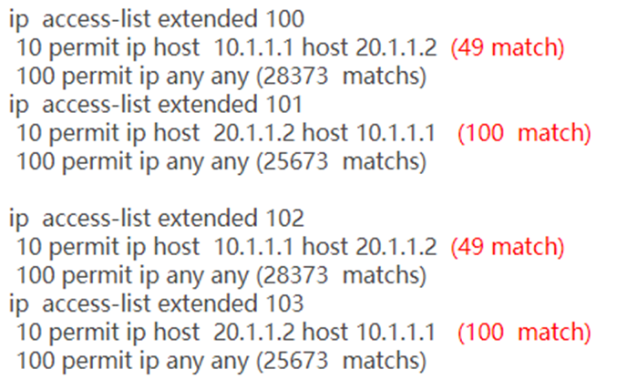

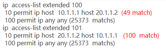

You can check the current ACL match results on theS86 and S5750 devices by using the commands show access-list 100 and showaccess-list 101.
S86:
show access-lists
S5750:
ACL Troubleshooting Results
Through the above tests, it was found that the S86 can send packets but does not receive responses from the terminal. The packet loss point is on the downstream device of the S5750. You can apply ACLs on the downstream switch to further pinpoint the packet loss location.
