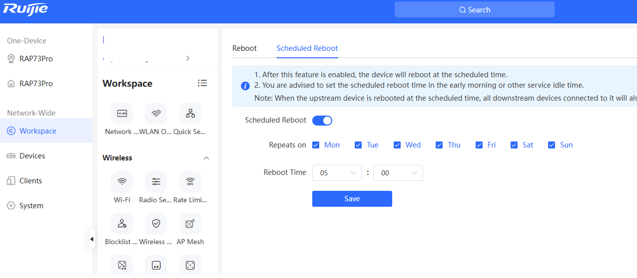

1. Check if the device is configured with schedulesd reboot
Log in to the SON interface to confirm whether schedulesd reboot
is configured.

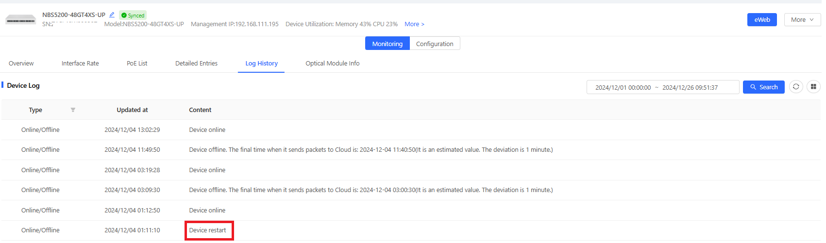

Log in to the uplink switch and check if the switch has restarted.
You can check the switch log in the cloud to see if there is a restart record. If there is, you can compare thefrequency and AP restart frequency to see if they are similar. If they are similar, the AP restart is caused by theuplink switch restart, and it is recommended to investigate the cause of the switch restart.

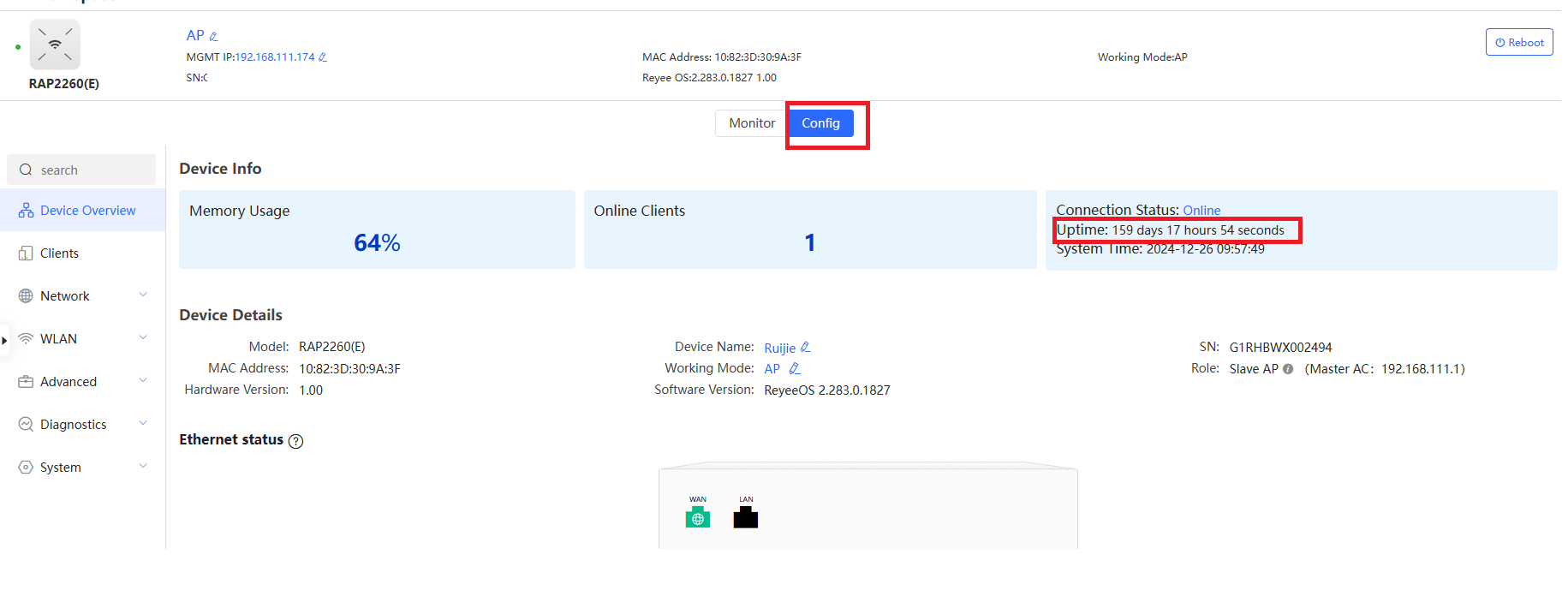

In addition to the above methods, you can also compare the uptime of switch and AP. if the uptime is similar, it means that the last time switch and AP restarted was at the same time. It is recommended to investigate the cause of switch restart .
View AP uptime:

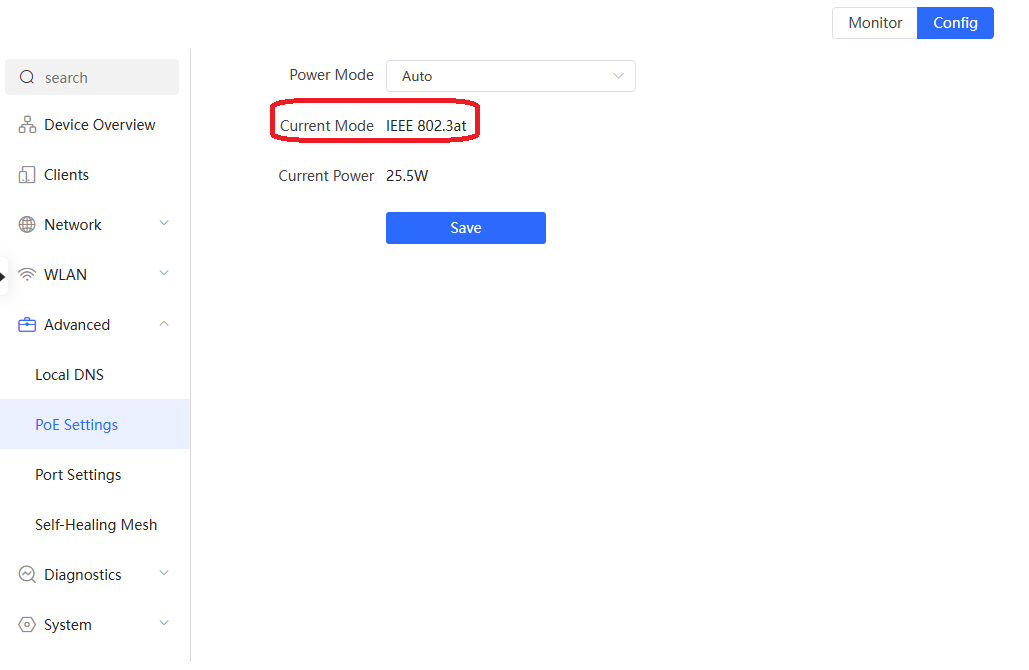

3. PoE negotiation abnormalities result in insufficient or unstable power supply
Check the POE negotiation result of AP to see if it meets the power supply requirements of AP, For example,RAP2260 (H) requires AT or BT power supply, which is not compatible with AF power supply. If the uplinkswitch only supports AF power supply (need to understand the uplink switch model and check its supported power supply standard), it will cause AP to reboot
Suggestions:
Replace the switch or adapter to the RAP standard.
