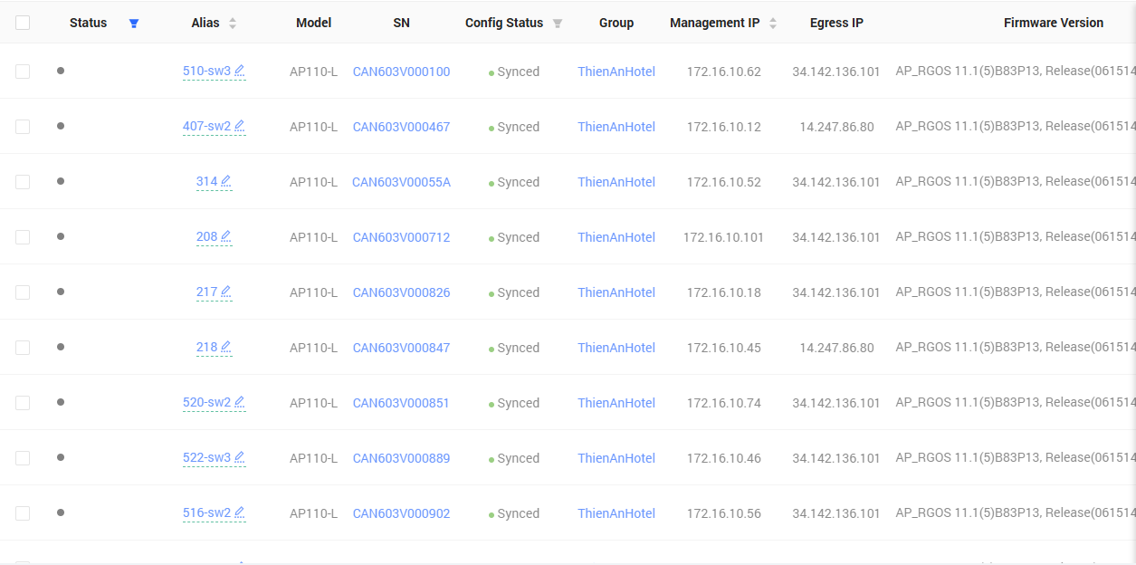

We are having problems. Many hotspots are offline. We have checked and found that the hotspots are working fine. Is there any way to fix this? Thank you !!
RG-AP720-L
Others Wireless Cloud
0 2024-12-30 16:27:56 View all replies

All my device models are Ruijie RG-AP110-L and it says device offline. but I checked and found the device is still working. i checked step 3 as your instruction. But before that setting is still the same. Is there any other way? Thank You !!

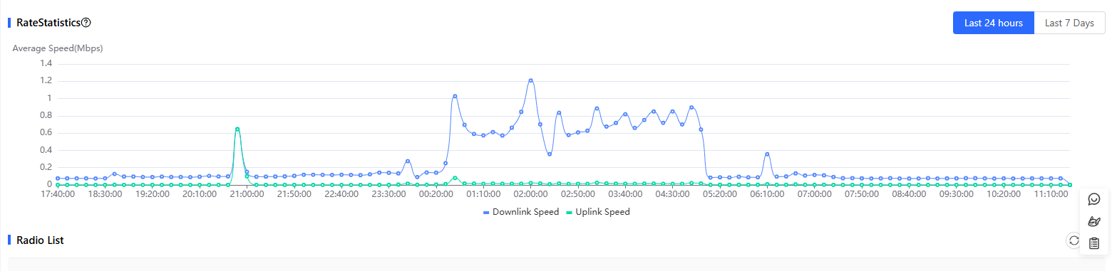

I checked the device and there is still traffic going through the device. This is the traffic on the offline device. Thank you very much.
