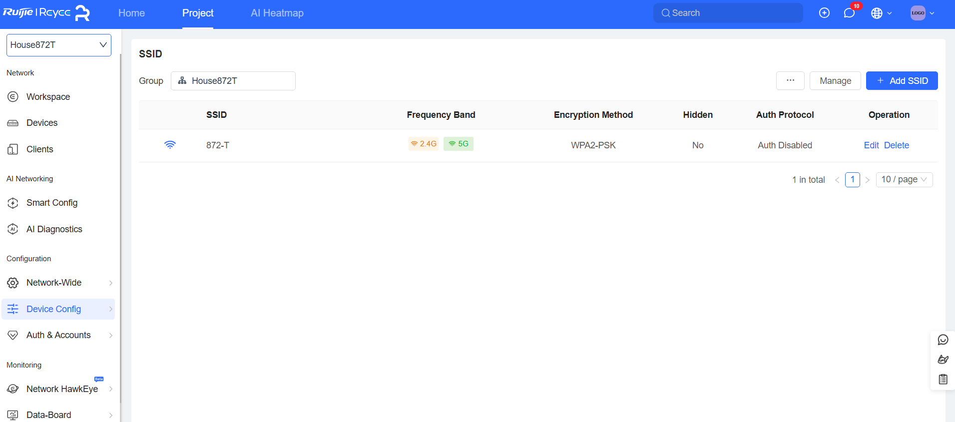

Hello,

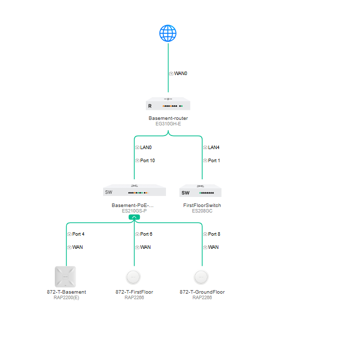

I have the following setup:
The problem is that no matter how I setup the SSID on the Ruijie cloud using [Device Config]>>[Wireless]>>[SSID], the SSID for the RAP2266 access points does not update. See my SSID setting in the cloud below:

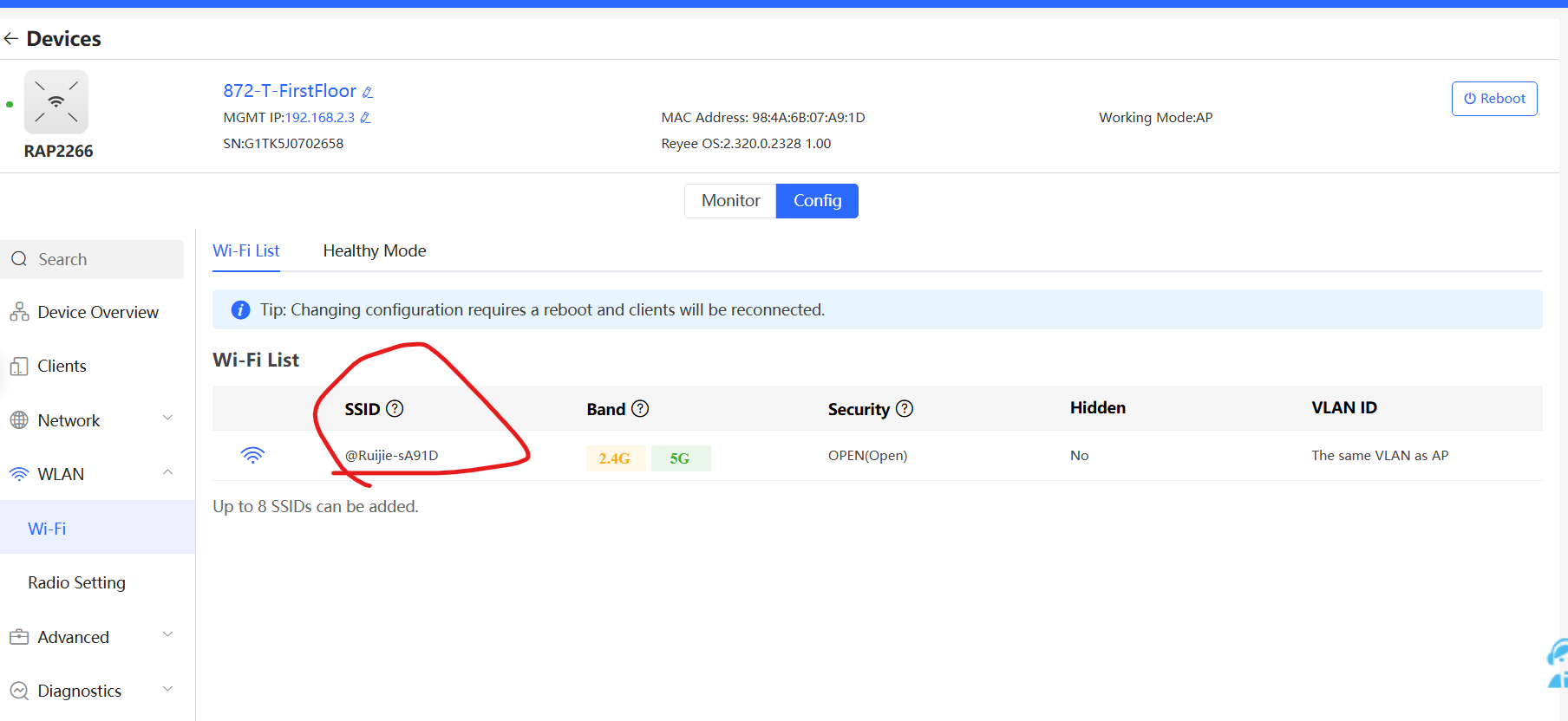

Now see the SSID for one of my RAP2266 access points from the eWEB interface:
How can I achieve a unified single SSID across all my access points?

Hi sir,
Thank you for reaching out.
This issue may caused by your RAP2266 not online from cloud, please kindly check how to make devices online from Ruijie cloud here:
https://community.ruijienetworks.com/forum.php?mod=viewthread&tid=3290
