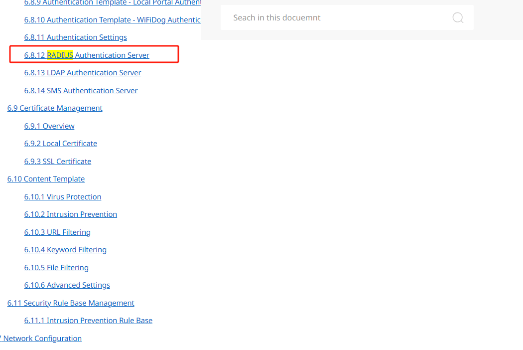

Hello Kiessen
Please kindly refer to this guide to configure/fix your issue. If the issue still exists, please help to collect the result of the network topology and network planning on your site and talk with me again. I would be glad to help you in Community.
