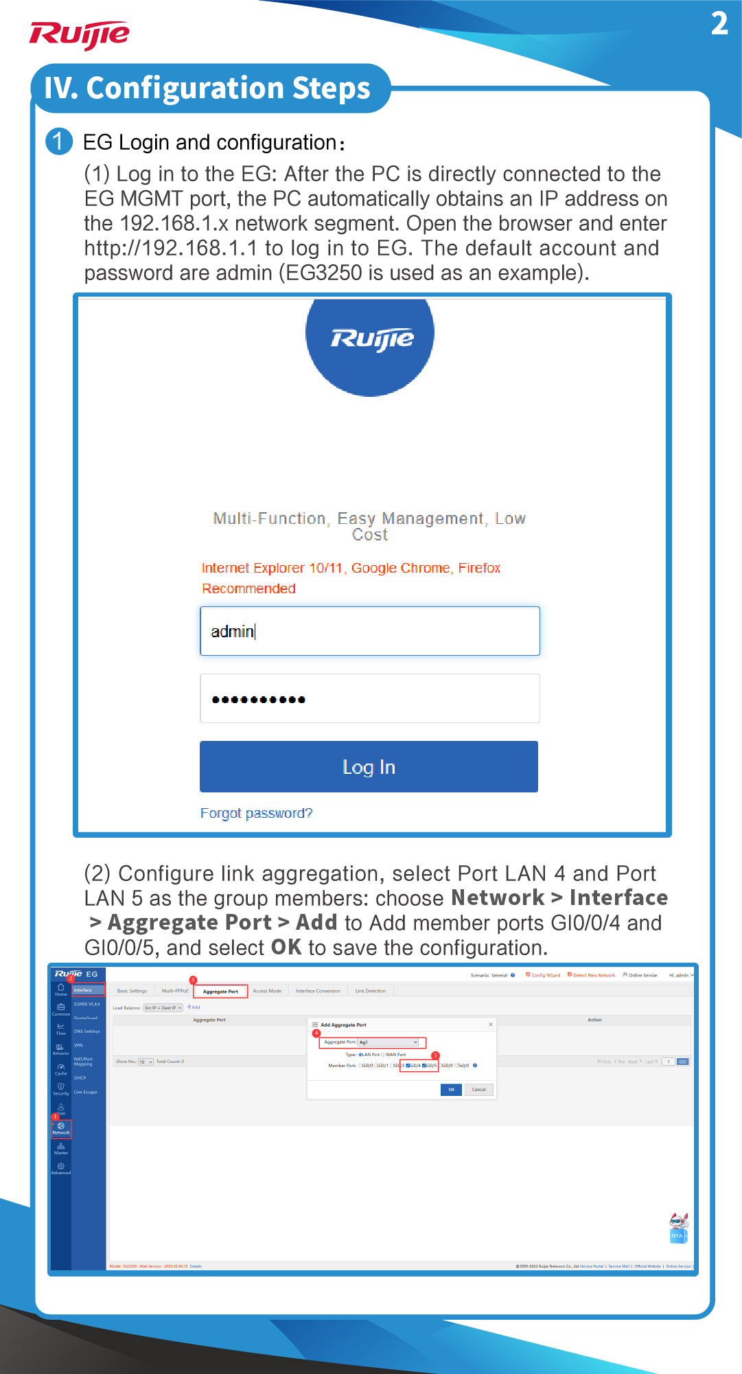

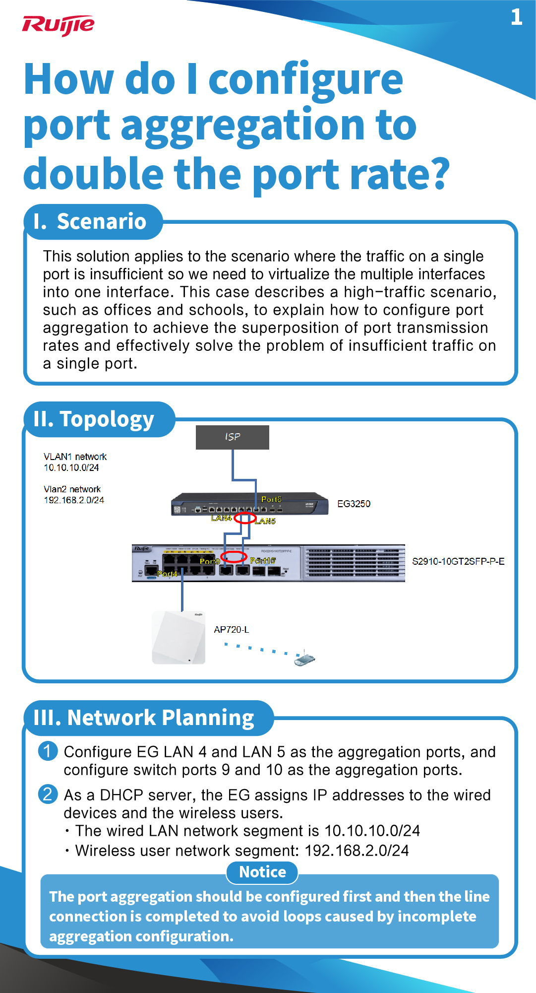

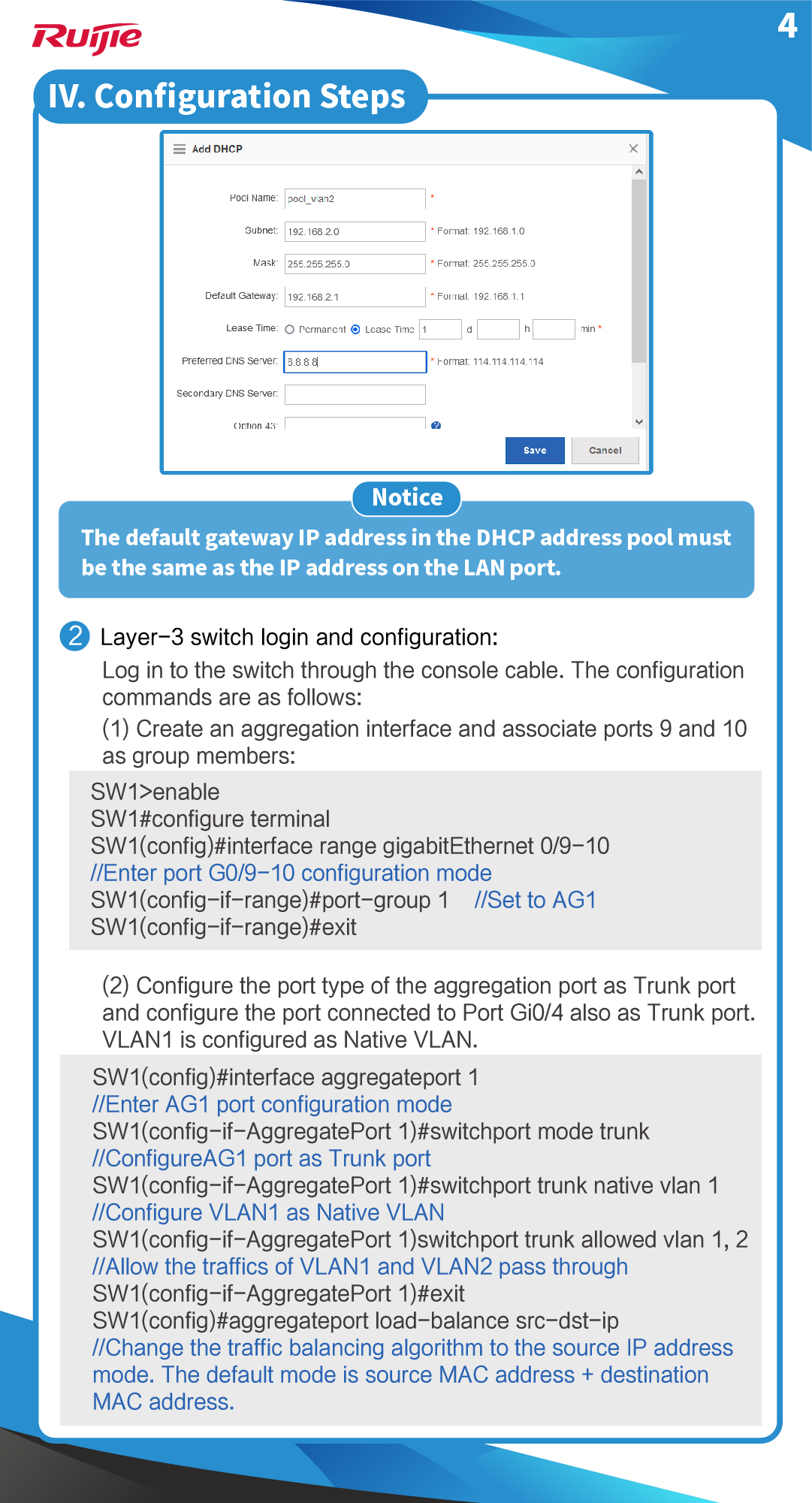

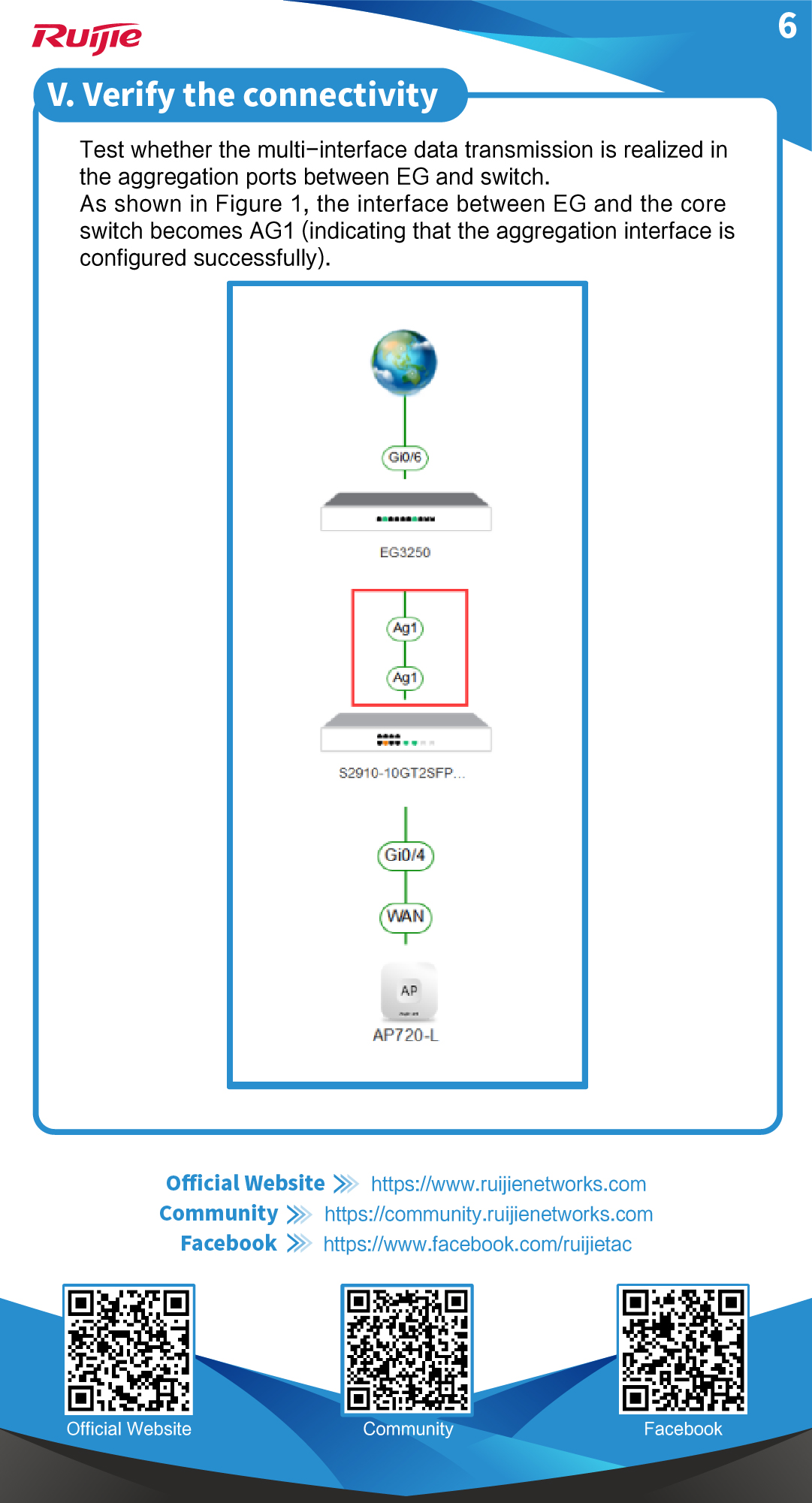

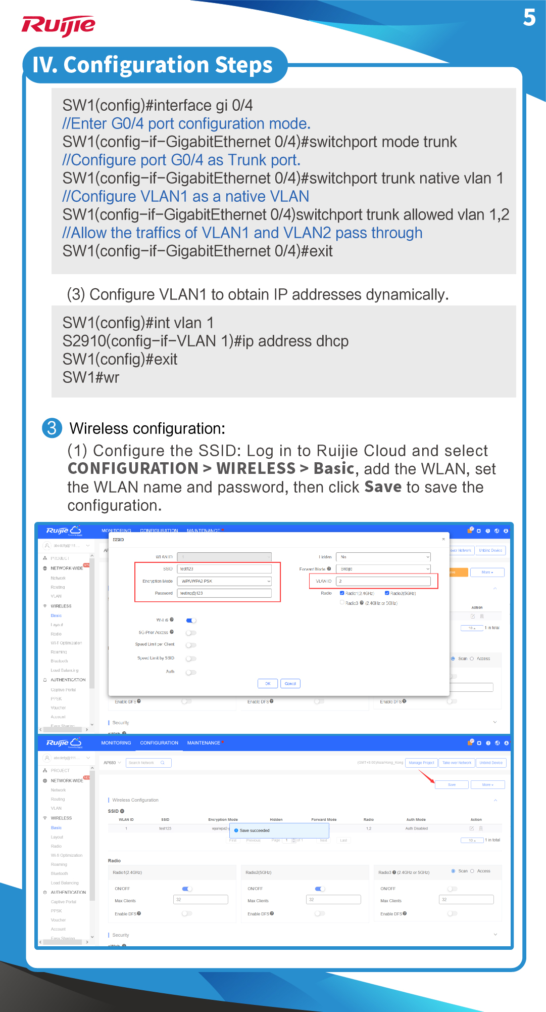

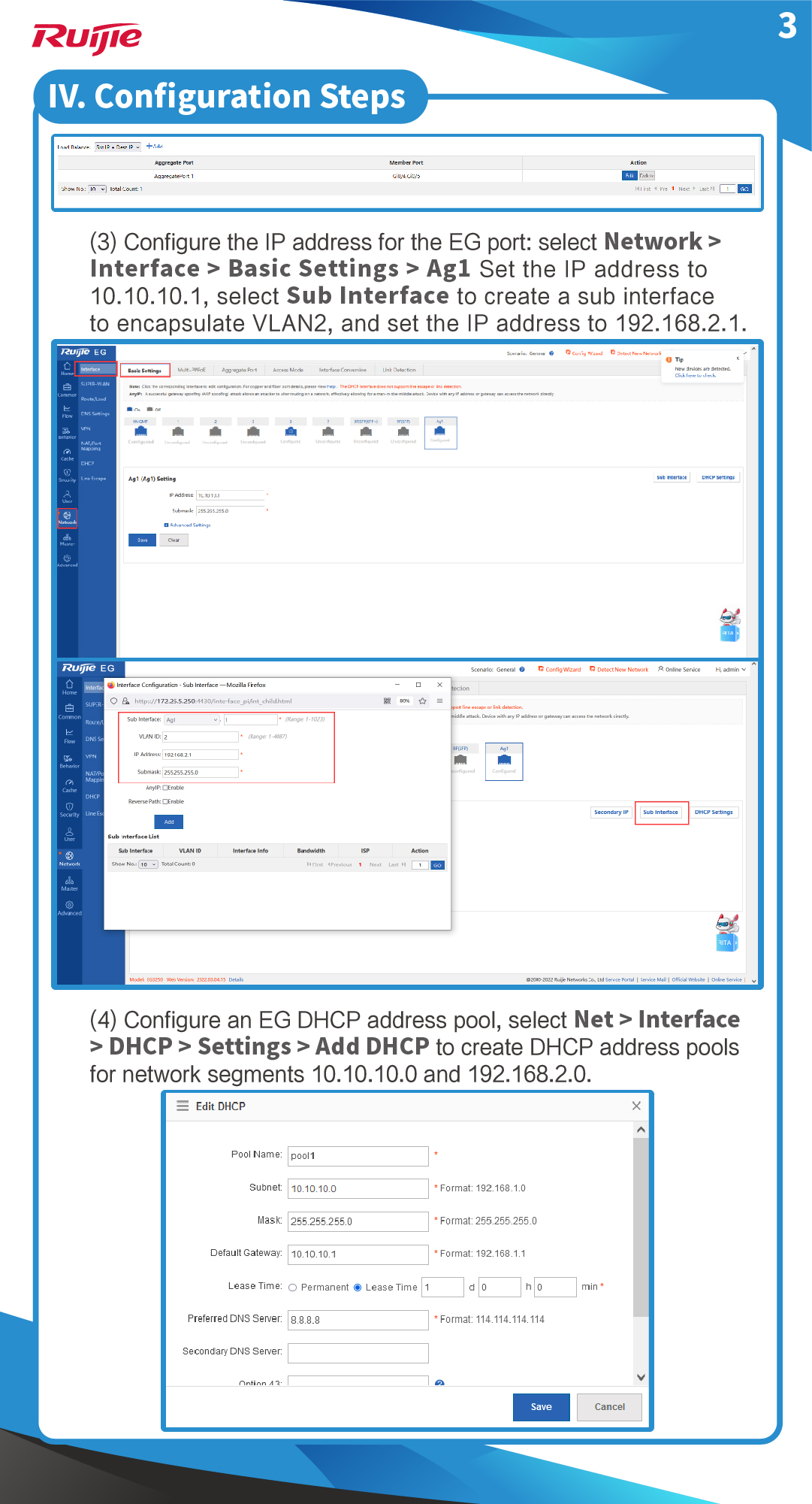

How do I configure port aggregation to double the port rate? Reply
GTAC-Eureka
