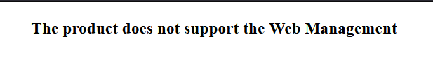

BTW we have another question about RG-S6250-48XS8CQ. When we  enabled http/https web-server it said that "The product does not support the Web Management", firmware version is S6250_RGOS 11.0(5)B9P124. Is this about firmware version?

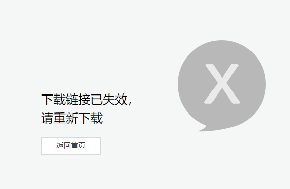

Link for RG-S6250-48XS8CQ isn't working

We 've added this line:
But when we try to connect by http we've got this message:
0 2022-9-29 09:19:38 View all replies
Alexander Zubarev replied at 2022-9-27 19:55
Sorry, it has been confirmed that RG-S6250-48XS8CQ does not support web login.

Hey, Joy!
Sorry for late raply. Link mentioned above seems like not working now.
Can you send me another link pls?
