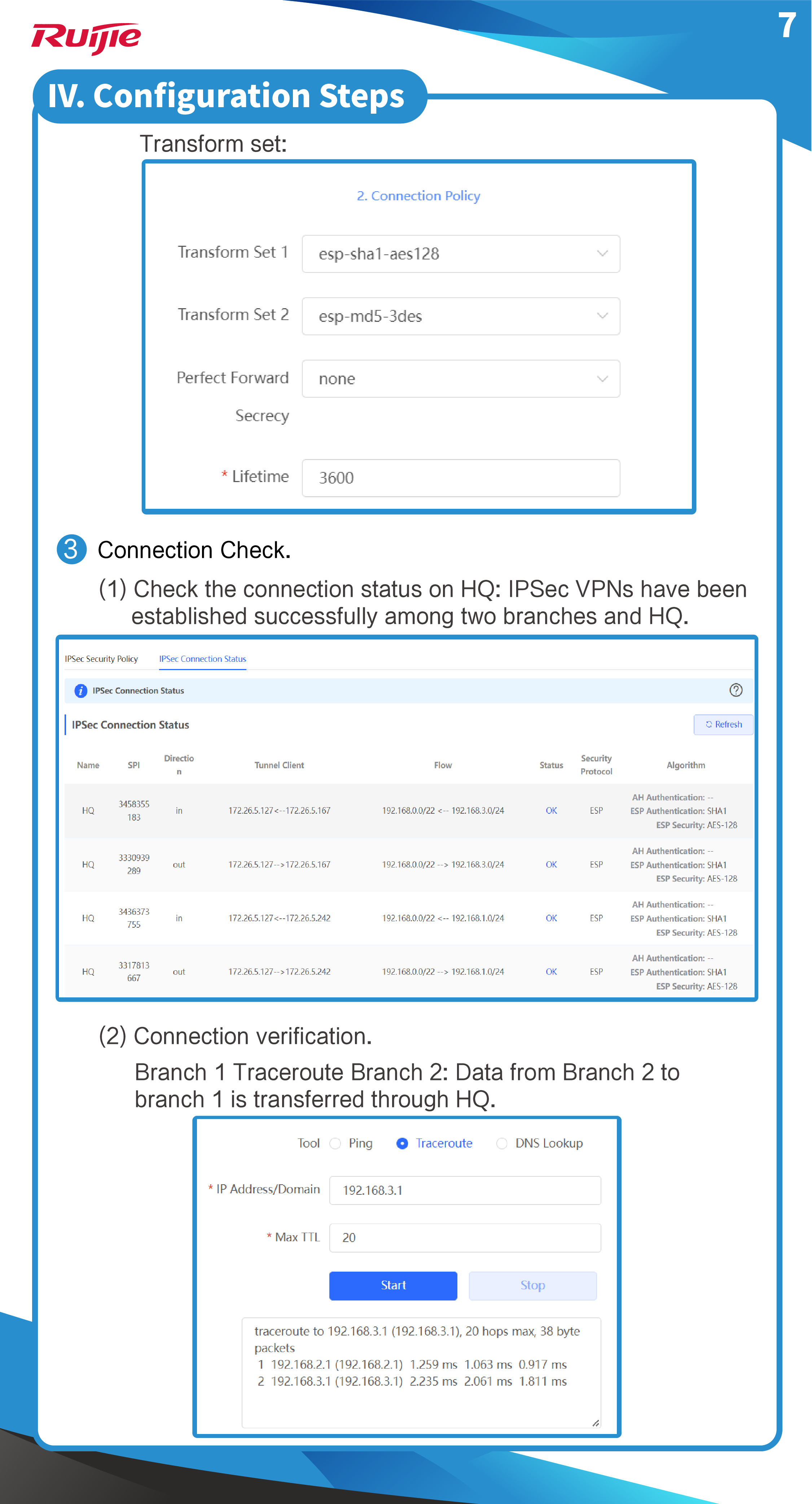

I try this but it did not work. Branch 1 cannot ping branch 2 only by performing this. Is there anything in VPN server (headquarter) need to be set such as routing or need spesific hardware require.?
my branch use EG105GW(T) while headquarter use EG210G-E.
I need branch to be communicate each other for VOIP server as each branch has its own voip server and not using the voip server in the headquarter.
