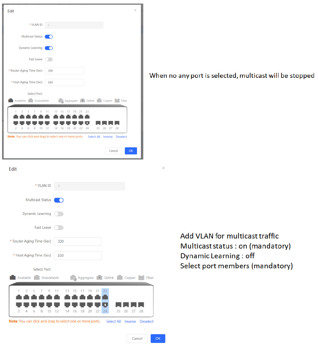

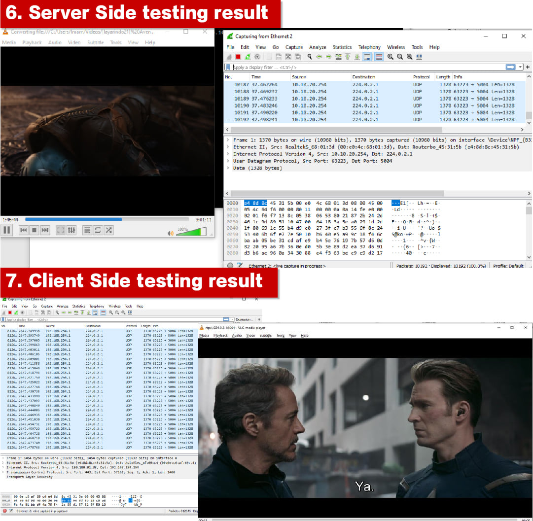

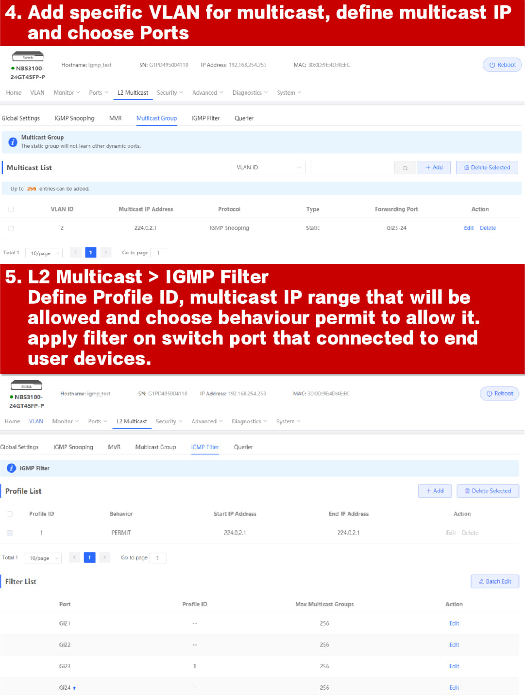

How to configure IGMP for L2 Multicast in Reyee Switch ?
12599 4 2022-4-18 18:00:10
Here's guidance.
PDF file download: How to configure IGMP for L2 Multicast in Reyee Switch ?
RG-NBS3100-8GT2SFP
